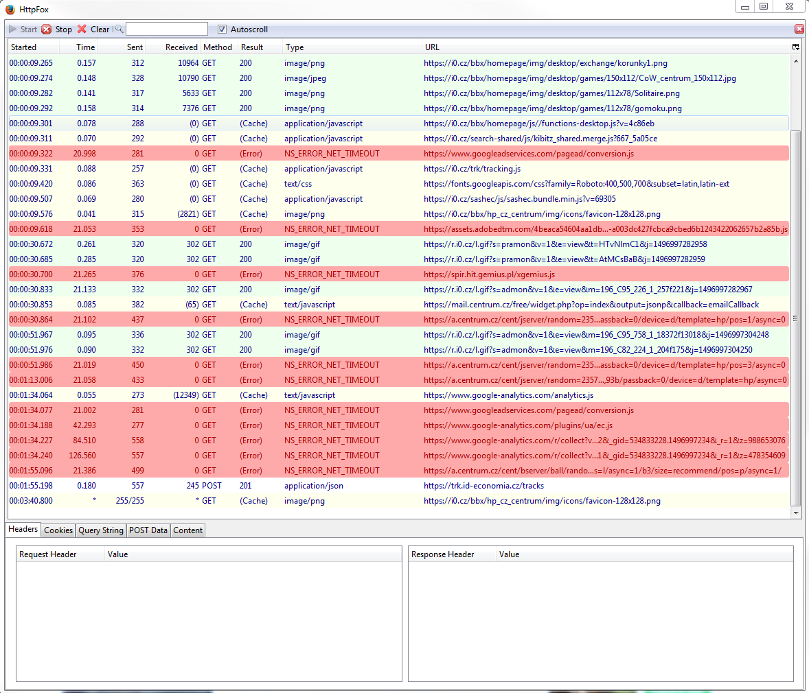

For examle request :
https://www.googleadservices.com/pagead/conversion.js
how it see on picture ...
Thanks someone to have some idea, how to solve this.

If you can use the F12 inspector on your client browser and take a look at the exact call that is causing the timeouts you may be able to see what asset it is that is causing the timeouts. If the browser rendering is blocking and waiting for a response, they typically show as red colored errors during the process.

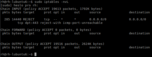

Here is my configurations iptables.
IPTABLES
IP6TABLES
