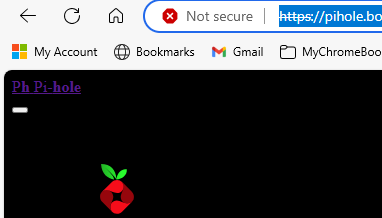

I am getting a browser security warning and this
I can access via IP address.

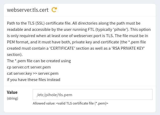

You can tell pihole the location of your certificates in settings -> click on 'basic' and it will toggle to 'expert'. Then go to All settings select the Webserver and API tab and scroll down to webserver.tls.cert
There was then a link to the docs below that TLS/SSL - Pi-hole documentation

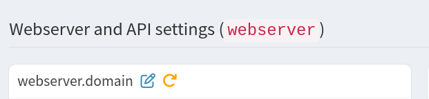

Also set the domain within
webserver.domain in the Webserver and API settings in pihole.

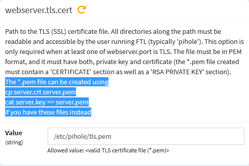

The web interface shows a very similar method:

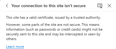

BUT - it accesses the site with the domain name and https but says insecure.
@robgill @rdwebdesign - is it expected behaviour that Edge thinks part of the 'site' are not secure even with a LetsEncrypt certificate in place on the server?
Are you trying to access it using pi.hole (as in your image above)? It would be expected to throw an error in that case (or via the ip) if you are using a certificate for another domain. It should not report it as insecure if you are accessing it via the domain name of the certificate.
I am using a domain ('pihole.xyz.net') for the VM Pi-hole is on and the certificate is issued for that domain.
The domain is LAN only and non-routeable (certificate done via DNS authentication).
It worked fine with Lighttpd.
I note the warning says 'some parts of this site are not secure'. I only have Pi-hole installed on this VM.
Well it seems to have decided all is well and the warning has gone. very odd! Thanks for your help.
