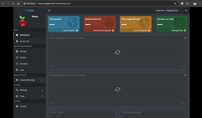

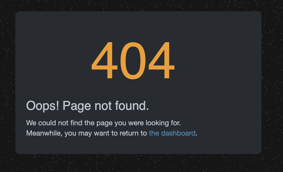

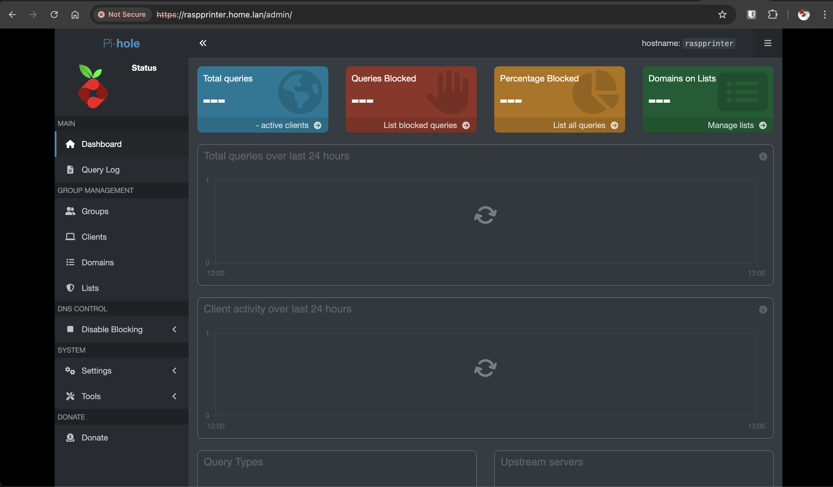

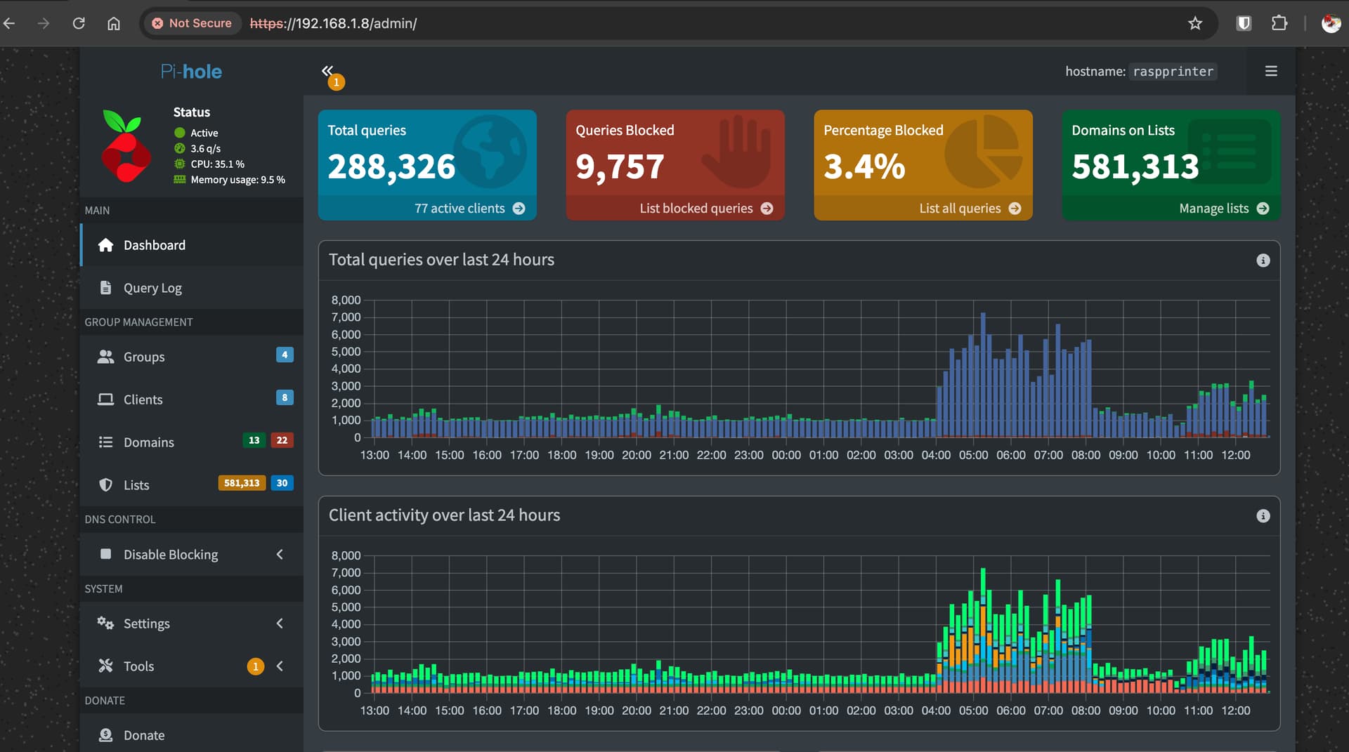

At this point, if I connect using the IP, all the dashboards work:
Whereas, when using the full domain nothing loads:
At least the web server is reading the certificate at least.
Final missing bit is that the way I joined the components seems not to be to the liking of version 6.
cat /etc/pihole/ssl/privkey.pem /etc/pihole/ssl/fullchain.pem > /etc/pihole/ssl/combined.pem
Changing how I built combined.pem seems to have fixed everything!
