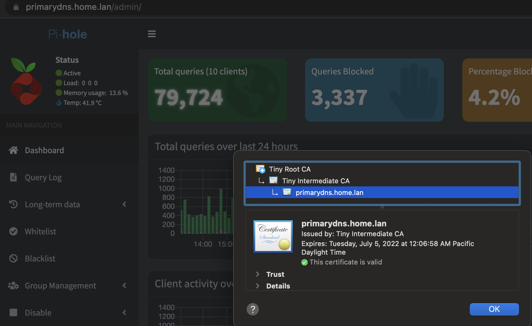

There is a need to go through a challenge process when you are using passive revocation, which I am. This is all local to my homelab, none of the processes I am discussing here pass out to the open internet. The domain I am using in this case is "home.lan"
You can see how short lived my certificates are here (and they work great!):
