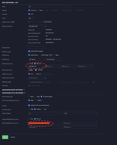

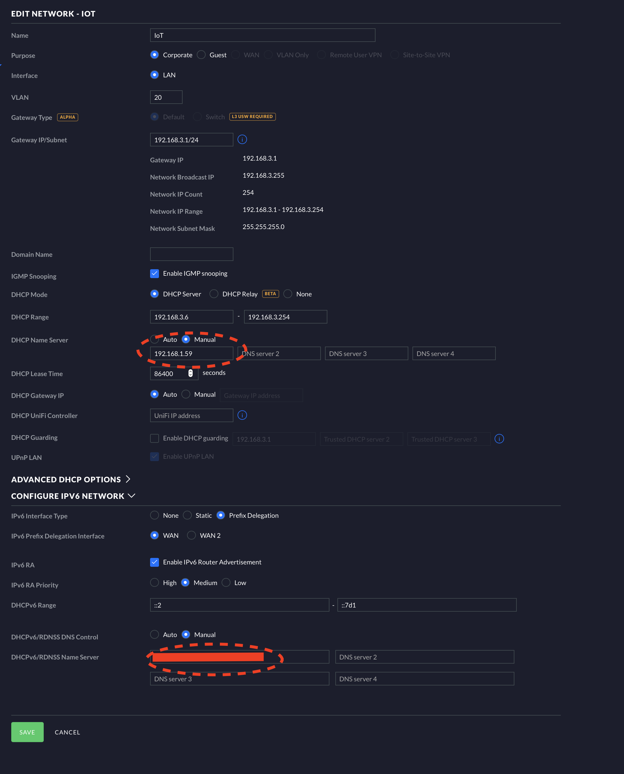

My Pihole (with unbound) seems to work ok on my LAN for a while, however I never managed to have it working on my VLANs.
as soon as I was setting the PiHole IP in the VLAN configuration, I wasn't able to resolve any query.
I fixed the firewall and add the PiHole as DNS for the VLAN again, weirdly I seems to resolve DNS query although they are all unfiltered.
I don't see any of the VLAN's IP on the PiHole webIf (Query Log, and Network tab)
I don't really understand as both the LAN and the VLAN have the same DNS configuration now, and clearly my IoT VLAN have it's queries resolved (unless somehow he is using unbound bypassing PiHole ?
