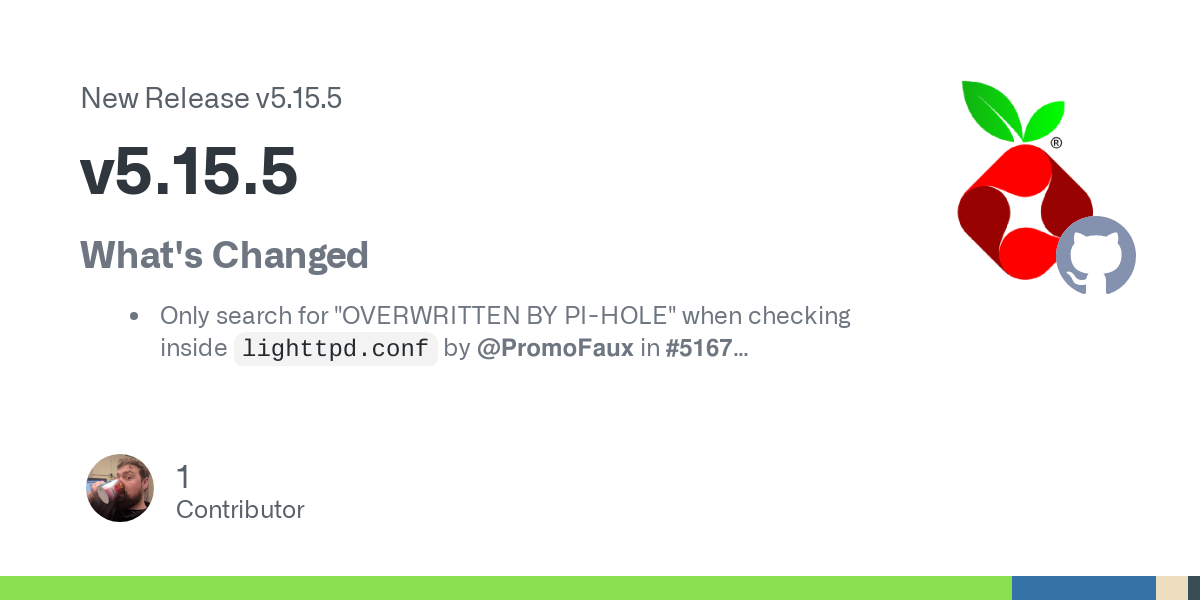

What does the top 10 lines of your /etc/lighttpd/lighttpd.conf look like? Specifically looking for the comment block contents at the top of the file.
root@DNS-Stack:~# head -n 10 /etc/lighttpd/lighttpd.conf
# Lighttpd config for Pi-hole
Sorry, I meant the block that mentions not to change the file contents.
#     FILE AUTOMATICALLY OVERWRITTEN BY PI-HOLE INSTALL/UPDATE PROCEDURE.     #
#              CHANGES SHOULD BE MADE IN A SEPARATE CONFIG FILE:              #
#                         /etc/lighttpd/external.conf                         #
Thanks, that doesn't look right, there was a change to that file to no longer modify and I think you have half of the changes.
Do you know what version of the core you were at before you did the latest pihole -up?

Thanks, the check for kernel runs uname -r to get the currently running kernel and then checks to see if /lib/modules/ has a subdirectory that matches the running kernel version. If they are different then the currently running kernel is missing libraries. That often means the libraries were updated via apt yet the kernel has not restarted to match the libraries.
Can you do uname -r and then check if there is the proper /lib/modules/(uname -r)?
In the meantime, I've rolled back the core update that I think is making this an issue.
The /etc/lighttpd/lighttpd.conf file needs to be changed, will update the detection function to make sure that people that update from a version prior to v5.15 will make it to where they need to be.
