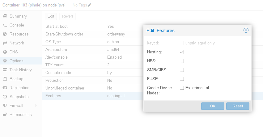

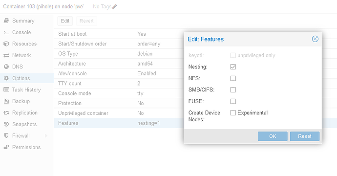

I was hit by the same problem, running pihole inside an unprivileged LXC container with Proxmox as host OS.
The reason why this breaks is the new systemd unit file for FTL which has these options:
ProtectSystem=full
ReadWriteDirectories=/etc/pihole
To fix the problem, the container should have nesting enabled in Options. This also applies for regular LXC containers, lxc config set {container-name} security.nesting true.
I had the exact same issue and the change provided by JGC solved it.
For people who prefer the webinterface, nesting is under the options tab, the 'features' row in the table.
Enable nesting, boot the container back up and all is well again!
