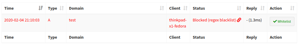

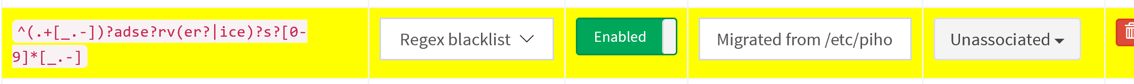

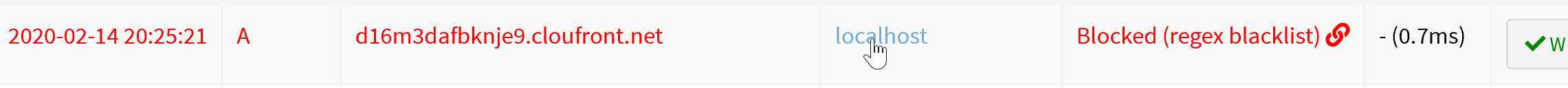

I see the link icon:
clicking the link item takes me to http://192.168.2.57/admin/groups-domains.php?**domainid=0**
In the test branch, the regex had a yellow background, the beta5 version takes me to the same view, however, there is no yellow background or any other indication, as to which regex is the cause of blocking.

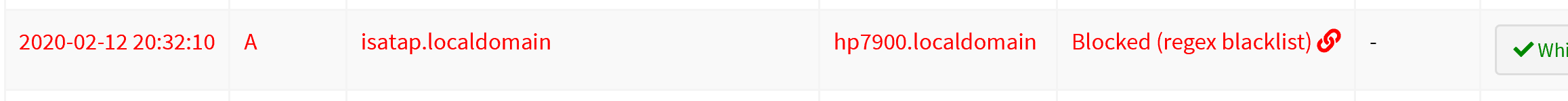

another test does succeed:
result the link is http://192.168.2.57/admin/groups-domains.php?**domainid=39**:
I assume the first failure is related to domainid=0, meaning no regex match. Does this have anything to do with localdomain in the first dns domainname (isatap.localdomain)?

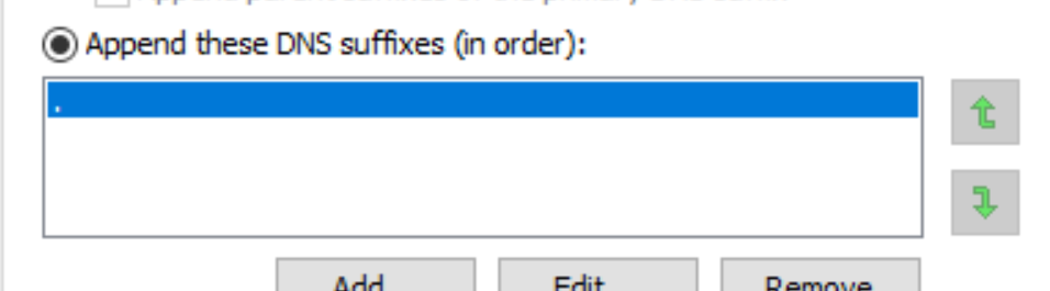

edit2

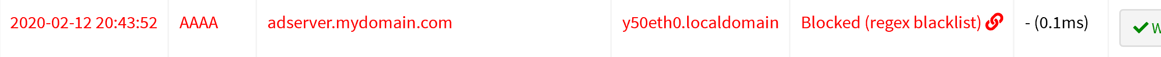

I was able to stop queries to localdomain with the following windows config:
/edit2
edit3
the cname lookup and display also appears to work as expected:

domainid=0 may be a thing, not found anything would be -1 and should be ignored.
Do you have a filter with id=0 in your database?
Check with
sqlite3 /etc/pihole/gravity.db "SELECT id,domain FROM domainlist;
You're welcome.
id=0 not in domainlist, first entry is 1

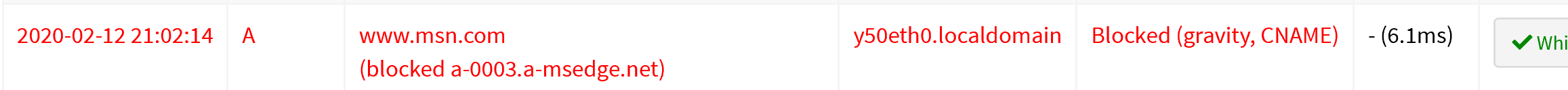

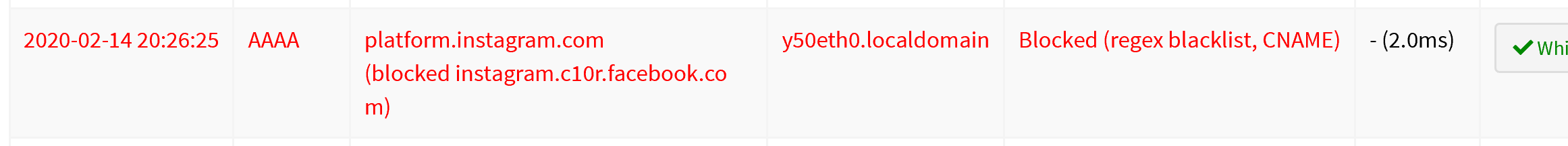

found another entry in the query log, not covered by the solution:
in the query log:
pihole -q says:
pi@raspberrypi:~ $ pihole -q platform.instagram.com
  [i] No results found for platform.instagram.com within the block lists
pi@raspberrypi:~ $ pihole -q instagram.c10r.facebook.com
 Match found in regex blacklist
   ^(.+\.)??(facebook|.*fb.+)\.(com|net)$
I would expect to see the link (regex match) in the status column, but it isn't there.

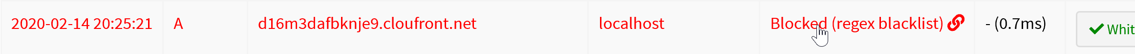

I assume you mean (only the web interface?):
pihole checkout web tweak/show_cname_regex_link
stopped pihole-FTL, removed database and logs, cleared browser cache.
Sorry, but I don't see any change (no link, no tooltip):

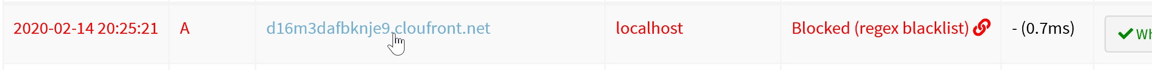

did you mean my suggestion to change the link sign into tooltip? if so, the entire text, including the link sign, is now a link, but the tooltip only appears if the mouse is on the link sign (which is now obsolete - the tooltip says it all...).
edit
the other fields (domain and client) turn blue on mouseover and show the tooltip (greenshot cannot capture tooltips).
/edit

edit Okay, so more work is needed inside FTL, todo for another day.
edit 2 The reason for the absence of the regex link is that we record the responsible regex ID for the domain that was blocked within the CNAME inspection but do not propagate this information up to the parent domain. WIP.

@anon55913113 @jpgpi250 Please try
pihole checkout ftl fix/db_regexlink_id
to get the expected CNAME links. There is a bit of additional bookkeeping FTL needs to do here for this to work.
I also updated the web code slightly for an overall more uniform experience.
