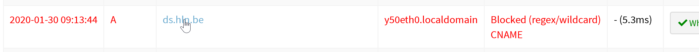

@DL6ER: You have created a very useful tool to help identifying blocked domains, as a result of CNAME blocking. Hope to see it soon in Beta5.
I would like to make a similar request for regex blocking. Currently the web interface shows:
It would be very helpful to show the regex entry, responsible for blocking the query.

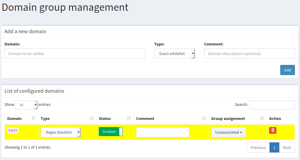

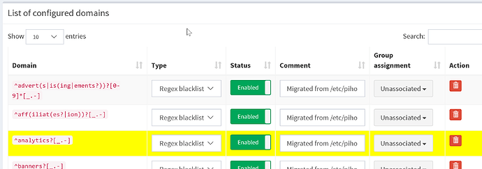

Queries blocked by a regex filter (either during CNAME inspection or directly) will present a link. Once you click on this link, it will send you to the domain group management page highlighting the matching regex filter.

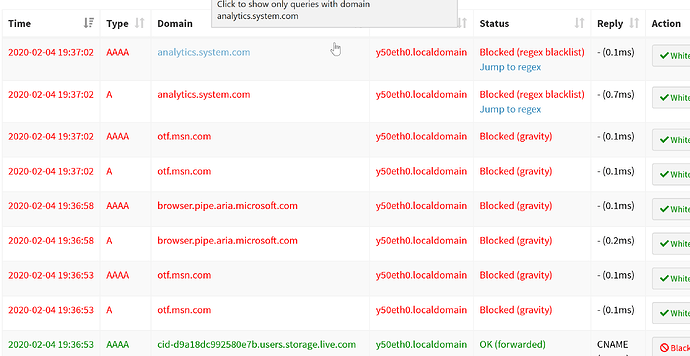

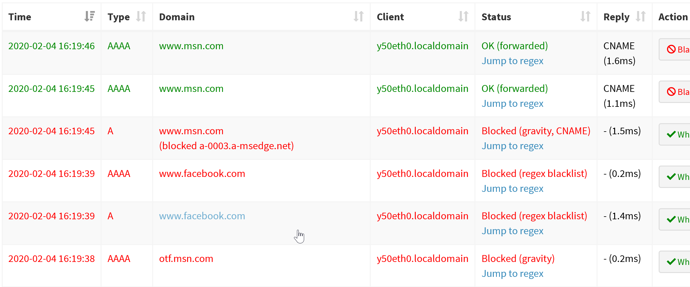

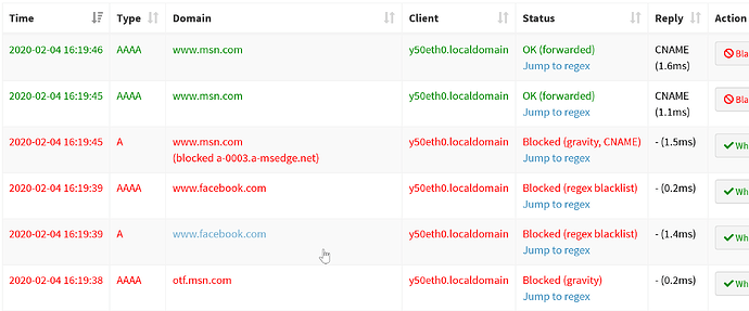

@DL6ER I've upgrades to the latest version and also seeing the link to "Jump to regex" now. It's a bit confusing that the link appears on all entries regardless of the status (see screenshot from @jpgpi250).
Can you adjust the code so that the link just exists when the status contains something with 'regex' in it?
I had some serious problems with the system where we tested the CNAME_inspection_details, so I reimaged (etcher) and tested again. It all appears to work as you described, so I deleted my earlier post, describing the problems, since they apply only to that system (already overwritten).
I agree, this is confusing. it would be an improvement to only show the link when it will work. You might even consider to simply turn the word regex into a link, no regex, no link, no need to add Jump to regex... (If possible).
Will this work for regex whitelist?
As you may have guessed, this is not intended :wink: Something went wrong and this just teaches me again to not "quickly push something before heading to work". I will push an update to FTL now.

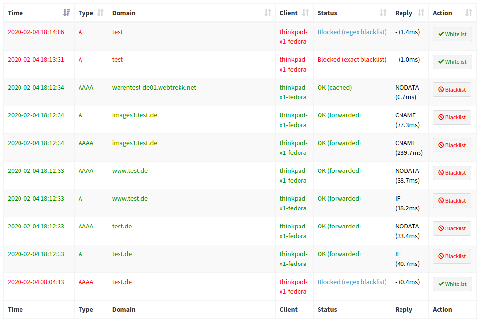

This also looks kinda strange:
Screenshot from 2020-02-04 18-14-56
I don't think I like it. Hint: I have not pushed this change upstream.

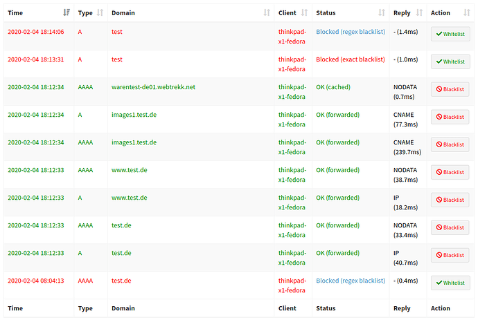

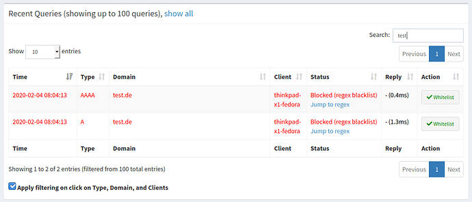

result (you are a genius):
query log:
after clicking the link:

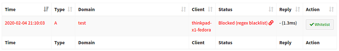

Whats about turning the whole status 'Blocked (regex blacklist)' into a link? I think this would be optimal.
Well, maybe not optimal but we obviously need some obstacle to signal users that this is clickable:
Adding a small 'This is a link'-Icon?
How so? Like this?
Yapp.
