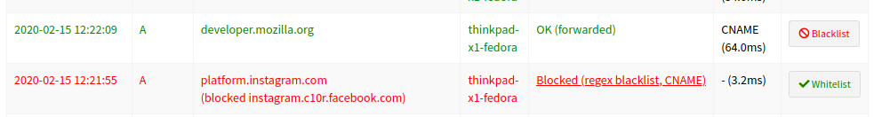

Request: show regex, responsible for blocking
YOU NAILED IT... GREAT WORK
and
I'll keep this running until after the weekend, to ensure there are no side effects or unexpected FTL crashes, but I'm confident! Hope to see this in beta5 soon.
Thanks again for your time, dedication, effort, persistence, …
edit
If somebody is going to write a manual on how to use this great new feature, you should emphasize CTRL clicking the link will open the group management page in a new tab, which makes life even easier.
/edit
What happens if you click normally on the link? I designed it in such a way that is should open a new tab. I'm not using HTML <a> at all in this code.
I use Edge (NOT Edge chromium yet) When I click on the link, the domain management page opens in the same tab (replaces the queries page). I use a wheel mouse. I normally open a link using a wheel click, which always opens the link in a new tab, but that doesn't work in the pihole web interface.
Also tested with firefox. The wheel click also doesn't work, but a normal click DOES open the domain management page in a new tab, so the behavior is browser dependent.
Okay, so this is something we cannot/should not do much about. The events are standard DataTables events and if Edge decides to handle them differently than the majority of other browsers, then we should wait for either DataTables or (rather!) the browser maintainer to fix this misbehavior.

Hmm, the link icon is a bit distracting in my view, how about underlining the text to symbolize it has a special meaning?

We're slowly getting there...now with an underlined link. Users should be familiar enough with the web that underlined text usually means "click me".
I guess there is no real way of doing it right with the regex link, the current way of doing it seems unobtrusive and highlights that there is something special about this text. We can leave it like this and see if users complain IMHO.
