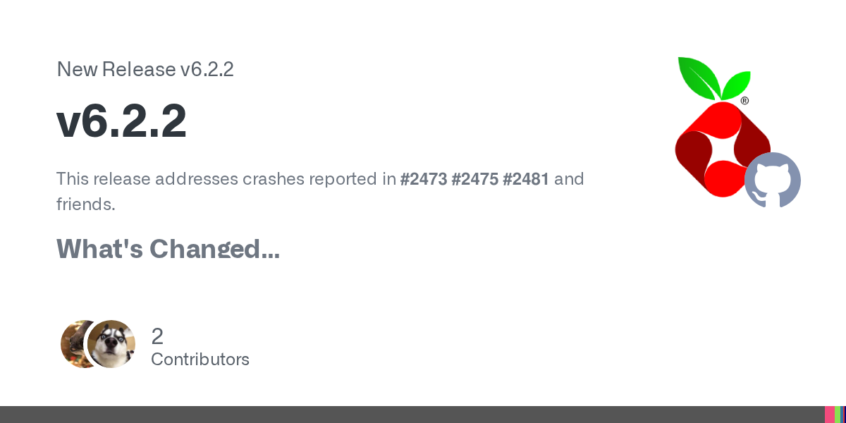

FTL v6.2.2 was released.

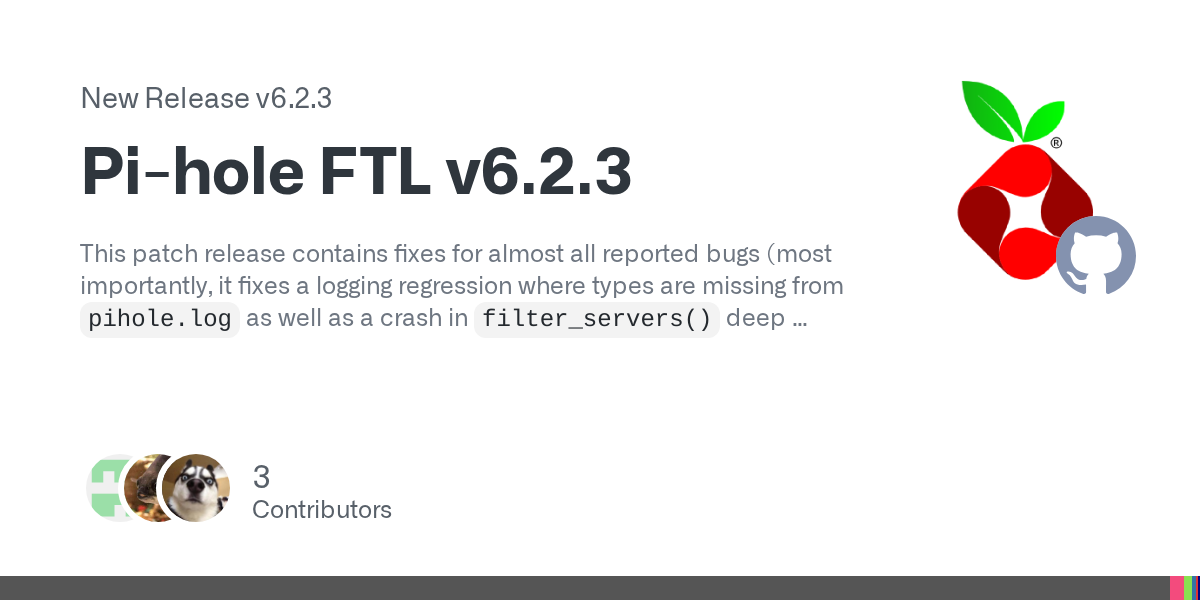

FTL v6.2.3 was released, fixing the remaining issues.
