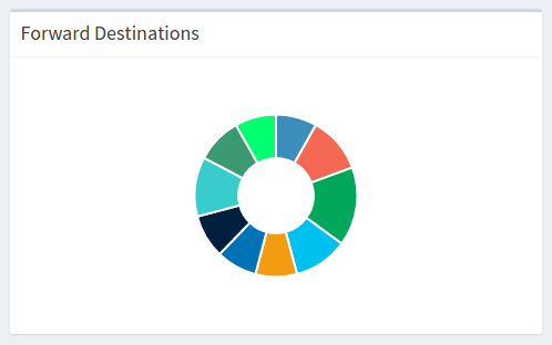

Yes. With the current version of Pi-hole you can use any number of servers (one or more). Pi-hole will query all of them from time to time and look for which server responds fastest. This one is favored. However, the time frame within which the favor property stays active is quite narrow so (except in high-density environment) you will most likely often see a fairly equally split amount of queries to a specific server.
Very low density environment (one client, large delay between queries):
High density environment (> 20 clients, up to dozens of queries per second):
You can see that in the latter case there is a clear preference for two upstream DNS servers (which are, in fact turn out to be OpenDNS primary and secondary).

Yes, OpenDNS seems to be faster than Google using Telekom DSL in between Cologne and Eifel.
NB: Level3 is also better than Google but slightly worse than OpenDNS.
