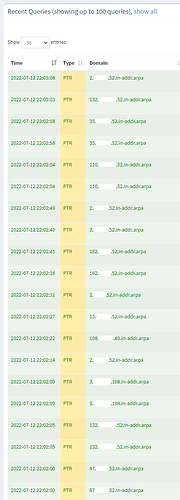

I have a work laptop that I bring between work and home as some of my work is done remotely from home. When connected to my network it just hammers the DNS server (PiHole) with reverse DNS lookup requests for IP addresses that aren't even on my network (My network is using a 172... subnet).
These happen quite fast and very consistently at at least 1 every 4-10 seconds sometimes with multiple queries at the same time.

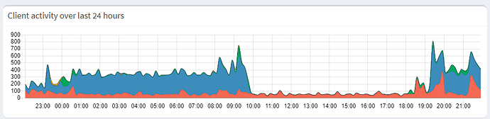

You can see the large dip during the day when I bring the laptop to work, and spike back up when I bring it back home. According to the dashboard, over 1/3 of all queries are PTR queries...
The hardware is more than capable of handling it, but it makes the logs really messy if I'm looking for anything since I have to sift through all these entries that I don't care about. I don't really care if it does it in the background, I just don't want to see it.
Is there any way I can completely exclude only this one device from PiHole and logs?
