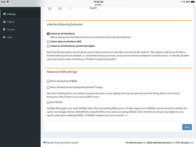

In order to make sure your hard-wired DNS entries respond appropriately for both inside the network, and via an OpenVPN connection, go to PiHole settings and on the DNS tab make sure that under Interface listening behavior you select the radio button listen on all interfaces and uncheck all entries on Advanced DNS Settings
Now go to your router and change your DNS settings so that it points to only your PiHole server. Every client that connects from inside your network, or the OpenVPN tunnel will now use PiHole for DNS queries which allows you to use these DNS entires. Additionally even your OpenVPN clients will now have the benefit of PiHole blocking ads.
