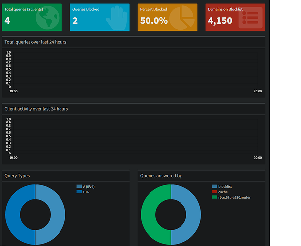

my pihole was running fine but suddenly stopped working yesterday. It just received no more requests, despite me changeing anything.
Today I set it up completely from scratch, but I can't get it to work anymore
pihole as it should
pihole not receiving any queries

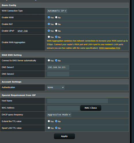

All my devices take the router IP and 1.1.1.1 als DNS, even i entered pihole as DNS in the router settings...
I am totally confused.. factory resett my router, didn't change anything...
If you didn't change anything DNS related yourself, a recent firmware update for your router may have introduced those changes.
Also, some routers do offer features dubbed parental control, intelligent protection, OpenNAT or similar that may interfere with DNS.
Those screenshots are from an Asus router.
Bucking_Horn is correct:
Most likely the router is also pushing its own IP address for DNS to the clients alongside the DHCP-->DNS setting from the screenshot.
