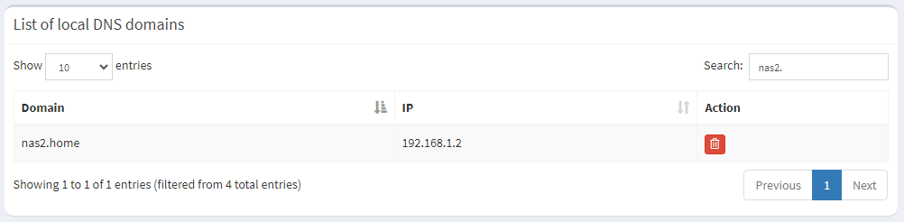

Thanks. This makes more sense now. I have my name defined in the Local DNS Records section of the web UI and it seems like pihole is recognising this and resolving it correctly, but that doesn't answer the original question about the [HTTPS] queries being sent to the internet. Since Pihole doesn't understand [HTTPS] queries, does this mean that all DNS requests for my local resources from a web browser that uses DNS over HTTPS is sent to the internet and there's no way to stop it?
