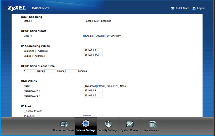

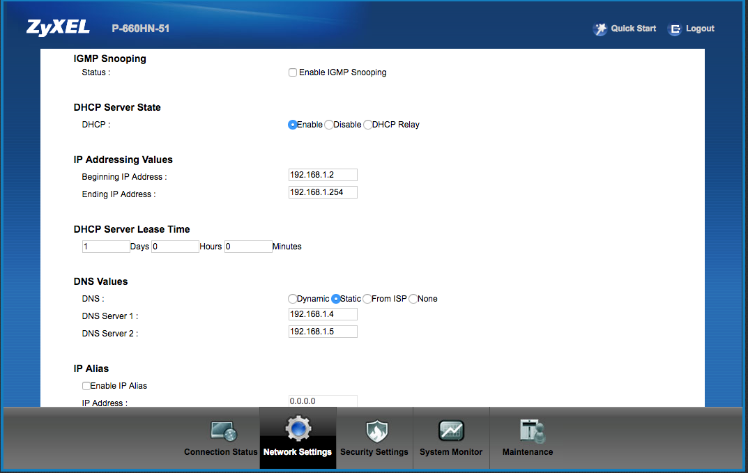

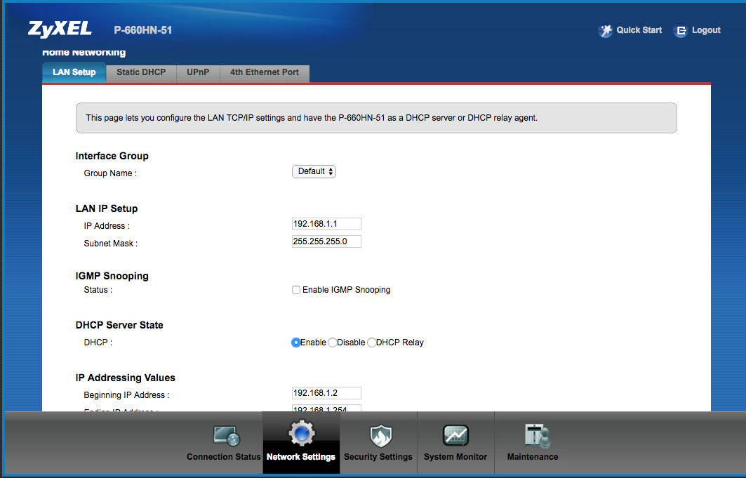

Heres some pictures of where I have tried changing on my router:
My pihole ip address is 192.168.1.4/24. I set the IP values under the DNS Values as you can see.

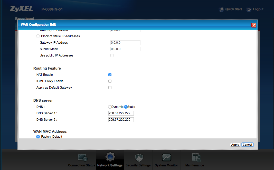

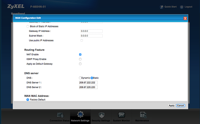

I also tried this underneath broadband settings where it says DNS server 1:
Right now the values are just set to OpenDNS because the other method caused my internet to fail.

I notice that your IP range is 192.168.1.2 to 192.168.1.254. But your DNS servers are x.x.x4 and x.x.x.5. My guess is that some other device on your network has been served the same address as your PI. This is probably the cause of your troubles. You can check by looking around on your router GUI for the list of connected devices and the IPs they have been given.
An easy fix might be to change your IP range from x.x.x.2-254 to, say, x.x.x.10-254. (Mine starts at 100.) This way your DHCP clients wont get the same IP as your PI, mucking things up.
So shrink the IP range your router will serve up. Besides preventing duplicate IPs, you'll have room to expand with further networking devices down the line. Plenty of room for static client IPs and other networking devices such as PIs, NASes, media servers, vpns, etc.
By the way, what device is 192.168.1.5? Do you have a second Pihole or something?

From second screenshot, change "Beginning IP address" into 192.168.1.10.
That leaves the lower 9 IP addresses to be assigned a static IP address.
From second screenshot, delete the second DNS server entry "DNS Server 2" (leave blank) or else, ads will still come through.
From third screenshot, leave as is or change back to default "Dynamic" DNS server.
Reboot your own PC.

Verify that your connected devices IPs have changed to reflect the new IP range you entered. Since DHCP leases are timed, some of the old IPs may still be active. Especially make sure that no device BUT the pihole has the x.x.x.4 address.
Also, I doubt this makes a difference to this problem, but if you can't completely eliminate that bogus x.x.x.5 address, I'd think about changing to something that doesn't have even the potential for a conflict. For example, 10.x.x.x.
It won't let me leave it blank, so instead of put a b.s. ip address in their (10.1.1.1). For some reason it's still not working though.
Put in the same address twice.
So DNS1 and DNS2 point to Pi-Hole IP address 192.168.1.4.
Whenever you make DHCP changes, reboot your own PC or disconnect/reconnect network!!!
It wont let me put in the same addresa twice. Thanks for the tip though.
If your router wont allow, only alternative I can think of is switching the DHCP server off/disabling on the router.
And flip on the DHCP server on the Pi-Hole web admin page copying most of the settings from your router like start and end IP range etc.
