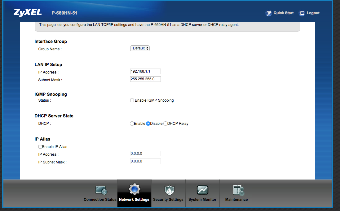

^ set to DHCP and reboot!
I'm not sure how to do that. Could you please explain what I'm supposed to set?
should I be changing the LAN IP?
Leave DHCP server disabled like on the screenshot.
Go to below link and lookup DHCP server and copy as many settings possible from the router web page:
http://192.168.1.4/admin/settings.php
And reboot PC !!!
EDIT: No dont change the static LAN IP address of the modem/router!

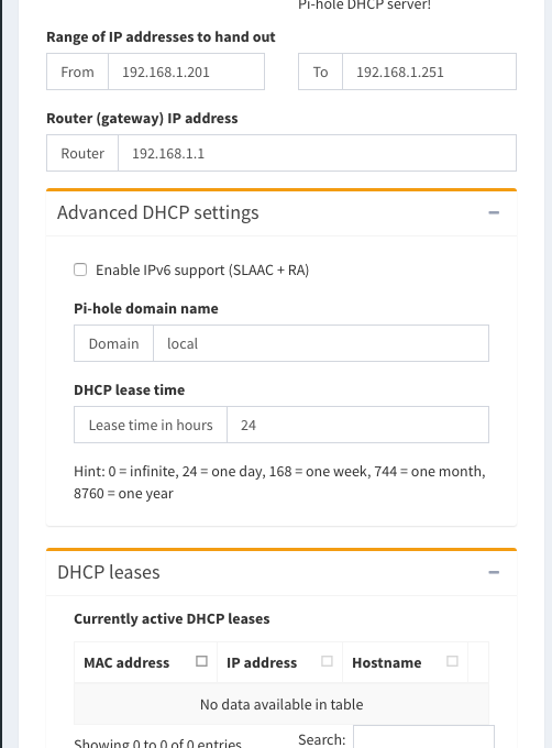

I cant see it because you cut off the top from the screenshot but you need to enable the DHCP server on the admin page:
It's been enabled for a while now and I rebooted previously with these settings when I tried the nslookup cmd. Sorry for the confusion.
