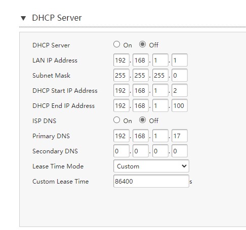

And these are my settings on the router:
Thank you

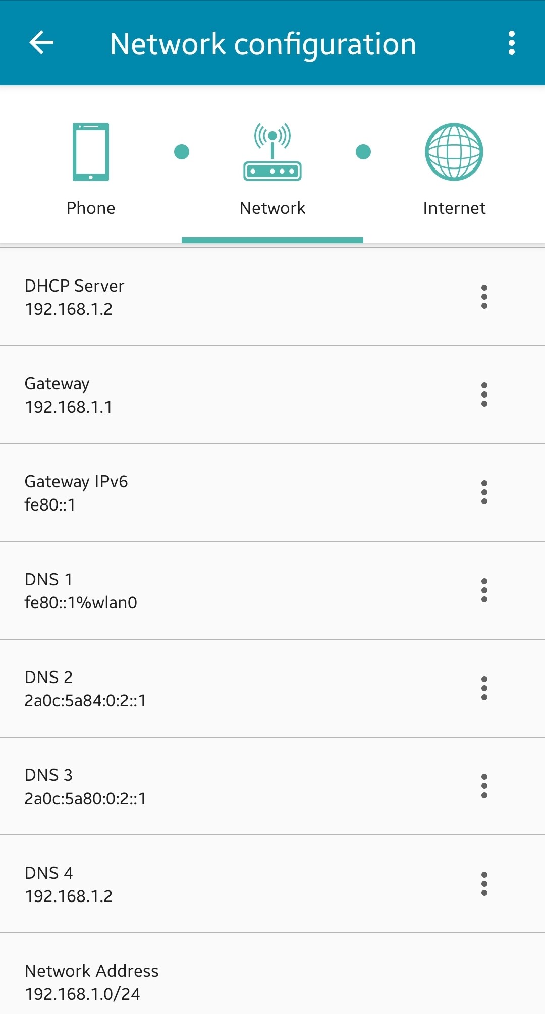

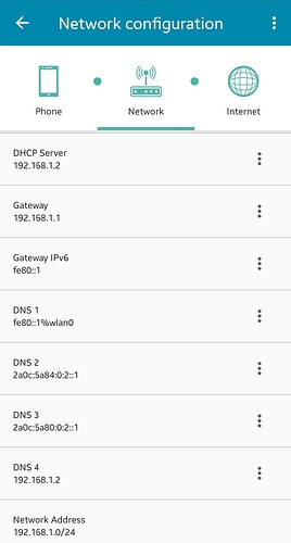

This is I think the issue with mobiles. I downloaded another android app to check which DNS servers are being used on the phone, and got all this crap which I don't even know where it comes from. 3 other DNS servers!
192.168.1.2 is the Pihole IP.
Those are DNS servers most likely received via IPv6 router advertisement (RA) or a DHCPv6 instance.
Those are usually hard to get rid of.
Check your router user manual if you can change those IPv6 RA settings or if you see any presence of DHCPv6?
Or else you could try disable IPv6 entirely on the router for the LAN side only.
Your clients dont really mind and also IPv6 is only a bit useful if your ISP supports IPv6 upstream:
Yeah exactly. Unfortunately my new ISP provides this router with some modified firmware version so you can change as little as possible, and that includes not being able to disable ipv6.
I'll call them to ask if they can disable ipv6 remotely. Otherwise I might just get another decent low cost router to use instead of the ISP', something which has support for custom firmwares.
Thanks for the info.
