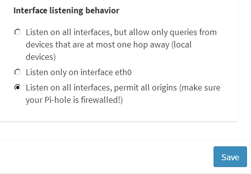

If you first get Pi-hole to work, you can change the listening behaviour on the admin web page:
Default, dnsmasq does that already with the "conf-dir=/etc/dnsmasq.d" directive in the file "/etc/dnsmasq.conf".

Brilliant stuff.
just by turning on listening on all ports it seems to work on vpn.
Thank you.
