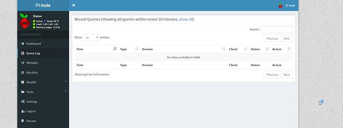

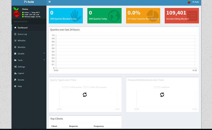

Pihole have no log files
Like the head says:
Ans i see no changing dashboard, while pihole is running:
Looks like Pihole is working...
Only will see the graphs and the log
maby try pihole -r then setup again so you choose logging on
