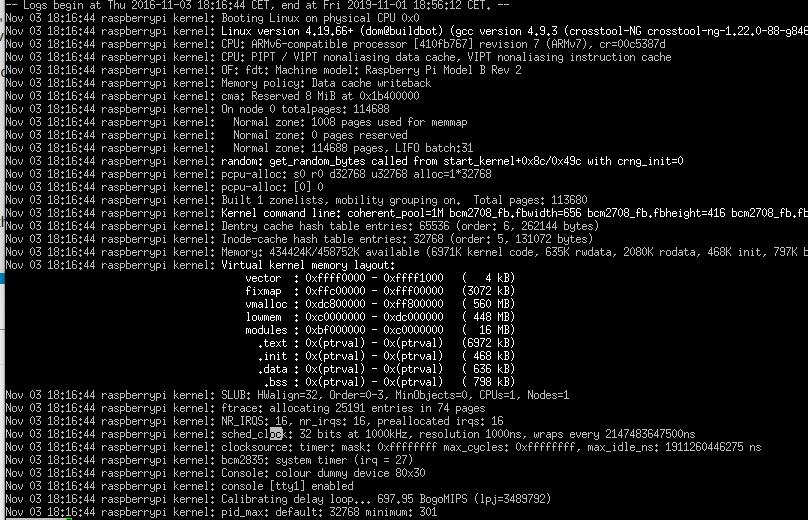

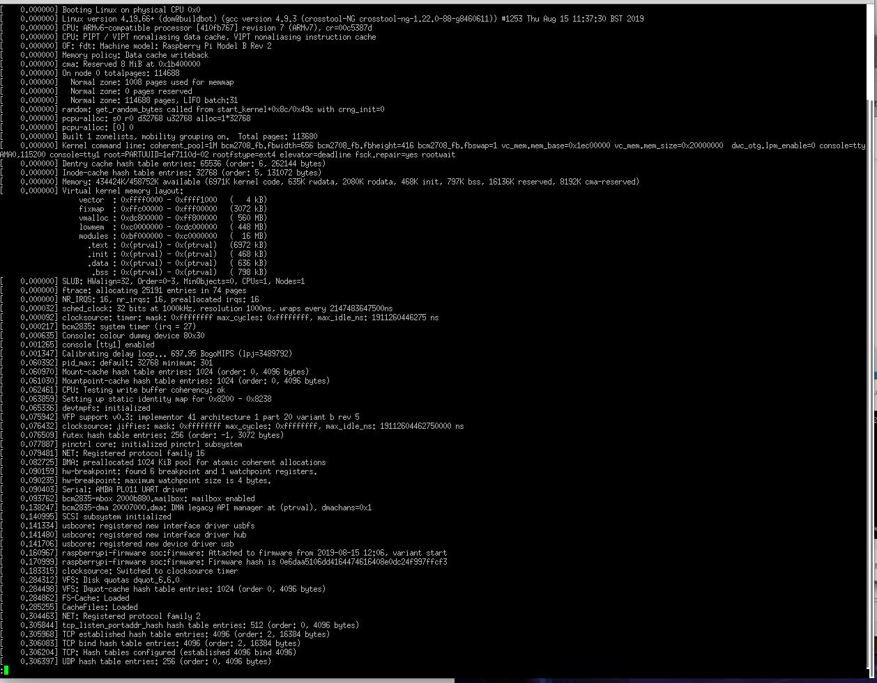

You may also find some system insights with these commands from the Pi terminal:
journalctl
dmesg | less
this is the pihole FTL.log... i ve indicated all you need.,. please let me know because i am not able to understand these log.. i suspect it s an hardware problem . but difficoult to find.
while i was reading the file the raspberry blocked. i ve see that the act led was red........

THIS IS PIHOLE.LOG
pihole-FTL.txt (24.8 KB) pihole.txt (2.7 MB) pihole-FTL.txt (24.8 KB) pihole.txt (2.7 MB) ]
GNU nano 2.9.3 pihole.log
Nov 1 18:51:31 dnsmasq[545]: reply dns.msftncsi.com is 131.107.255.255
Nov 1 18:51:41 dnsmasq[545]: query[A] ssl.gstatic.com from 10.0.0.2
Nov 1 18:51:41 dnsmasq[545]: forwarded ssl.gstatic.com to 1.0.0.1
Nov 1 18:51:41 dnsmasq[545]: reply ssl.gstatic.com is 216.58.198.3
Nov 1 18:51:46 dnsmasq[545]: query[A] dns.msftncsi.com from 10.0.0.1
Nov 1 18:51:47 dnsmasq[545]: cached dns.msftncsi.com is 131.107.255.255
Nov 1 18:52:01 dnsmasq[545]: query[A] clients4.google.com from 10.0.0.2
Nov 1 18:52:01 dnsmasq[545]: forwarded clients4.google.com to 1.0.0.1
Nov 1 18:52:01 dnsmasq[545]: reply clients4.google.com is
Nov 1 18:52:01 dnsmasq[545]: reply clients.l.google.com is 216.58.205.142
Nov 1 18:52:02 dnsmasq[545]: query[A] dns.msftncsi.com from 10.0.0.1
Nov 1 18:52:02 dnsmasq[545]: forwarded dns.msftncsi.com to 1.0.0.1
Nov 1 18:52:02 dnsmasq[545]: reply dns.msftncsi.com is 131.107.255.255
Nov 1 18:52:17 dnsmasq[545]: query[A] dns.msftncsi.com from 10.0.0.1
Nov 1 18:52:17 dnsmasq[545]: cached dns.msftncsi.com is 131.107.255.255
Nov 1 18:52:32 dnsmasq[545]: query[A] dns.msftncsi.com from 10.0.0.1
Nov 1 18:52:32 dnsmasq[545]: forwarded dns.msftncsi.com to 1.0.0.1
Nov 1 18:52:32 dnsmasq[545]: reply dns.msftncsi.com is 131.107.255.255
Nov 1 18:52:47 dnsmasq[545]: query[A] dns.msftncsi.com from 10.0.0.1

It seems you are running Pi-hole on Raspbian Buster.
Before you try out another RPi, consider running Raspbian Stretch instead.
I have been seeing similar random system halts that leave no discernible trace of what made it stop on a RPi Zero (which sports the same BCM2835 CPU as the Pi 1 models) with an Ethernet dongle - but only after I did upgrade to Raspbian Buster. The same machine ran Pi-hole on Raspbian Stretch without any issue for about year before that.
There's no guarantee that my single observation will also apply to your situation, but it's probably worth a try.
so you suggest a DOWNGRADE FROM BUSTER TO STRETCH?.. if i understand well.. how can i do this downgrade? thanks
thanks
I have not seen this. Upgraded from Stretch to Buster on two Pi Zero W's with no issues. Also did a clean install of Buster on another Zero W with no issues.
Stretch should be no problem, pihole is strongly stable here.
Exchange the SD Card. It might be damaged.
the sd is new... now i try with firmware update e move to buster
i will also stop the automatic reboot to see if with the new firmware and version i resolve the problem
I was using a RPi Zero, not the W variety, connected via USB Ethernet, but nonetheless, jfb's observations possibly invalidate my remark.
now i ve updated. removed the reboot scheduled. i will indicate the uptime without problem here next hours...
12 h with no problem. No reboot scheduled. I suppose it can be the firmware not updated..
