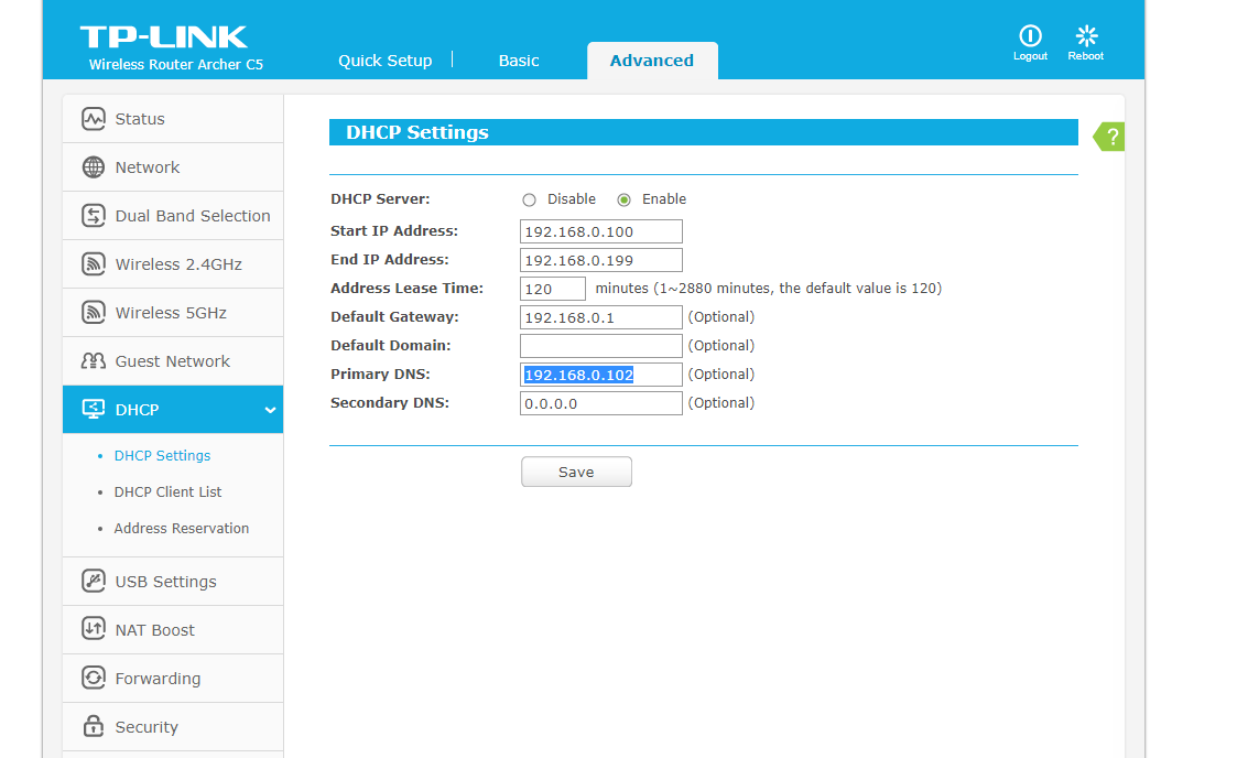

This is how the DHCP part looks. There's also something with DNS servers under "Network --> WAN", but nothing under "Network --> LAN". As I said, I don't know much about networking in general, but I feel like when it says "DHCP" it should be the right place.

DHCP settings are set correct on the screenshot.
That is the only setting on the router that needs changing away from default.

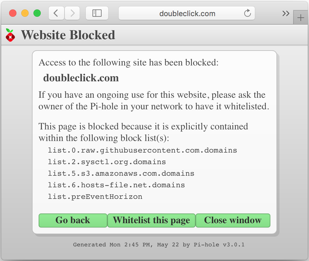

When on the Windows client, you open that domain "doubleclick.com" in a browser, a blocking page should display resembling below screenshot (might need to clear browser cache):
If all the above are correct, you can be sure that all the ad domains that are on the Pi-hole lists will be blocked.

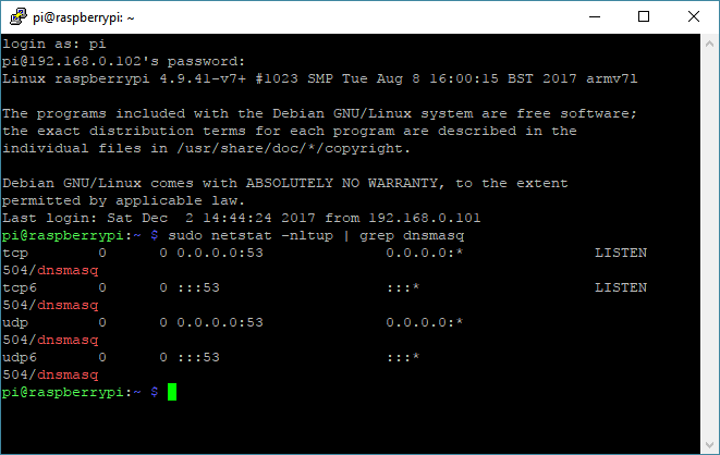

sudo netstat -nltup | grep dnsmasq
There's a lot of numbers here. See attached picture, because I wouldn't know what to look for.
