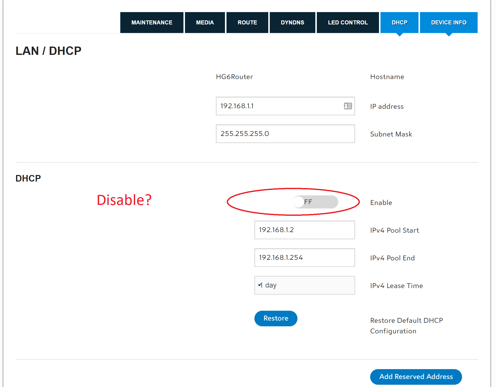

I am confused here, when it says disable the DHCP server on your router, do they mean this setting?
When I disabled this setting earlier, I could no longer edit the settings on the router and had to reset my router since I could no longer access the router IP address shown

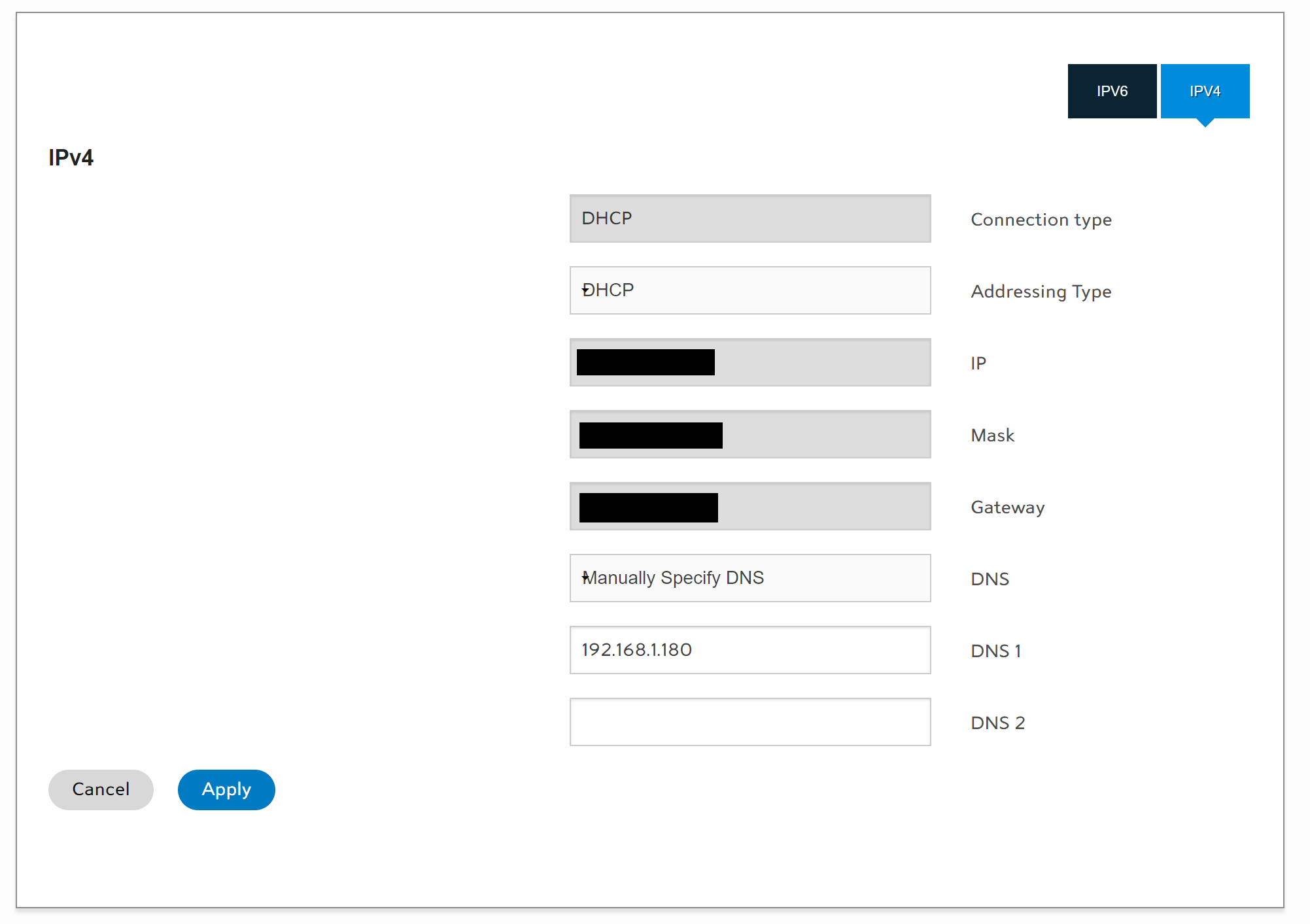

Here is what I have for the DNS server:

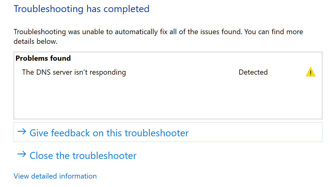

Note that only the Pi-hole address is listed there. However, when this IP address is the only one listed, no internet connection across all devices, and a windows 10 troubleshoot points to the DNS:

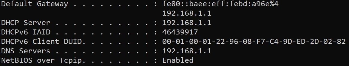

Here is also the result of ipconfig /all on the windows 10 computer:
It still displays the router as the DNS server
