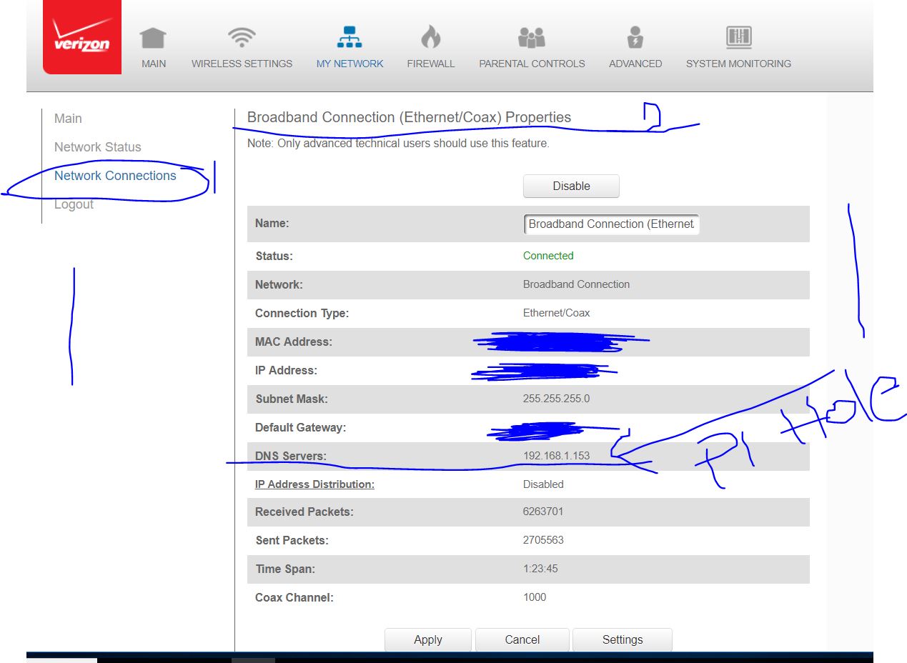

AFTER I remove the pihole as DNS server config in router , then internet works. But Request dint go through pihole.
THen after a min, I just put back the DNS server as pihole ( 192.168.1.xxx) in my Router , IT works for some time. See below log, it got reply...

NO Luck.. IT happend again ,... Its not able to capture response from OpenDNS...
I have to setup router to not use Pihole as DNS to access internet ..

Can you provide a screenshot of your router's Web interface of where you are setting Pi-hole as your DNS server.
Please check attached

This is very weird. From what I can tell right now it doesn't seem to be a direct Pi-hole issue but rather that your Raspberry Pi is not able to either
  • reach the Internet at all, or
  • reach only the upstream DNS servers.
Please configure it again such that is will stop working after a short while. Please try the command
dig pi-hole.net @208.67.222.222
once before it fails and once after there is no DNS resolution possible.
Thank you so much for all your help. YES, Unfortunately Verizon box had issues at the same time I installed pi hole. And Verizon tech confirmed that their box is dropping IP and not able to provide internet connection. They replaced with a new Box and its all working good so far.
Its Solved!!
