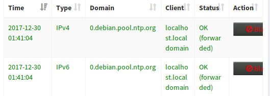

Pi-hole has not received any DNS queries, even though both my router and my devices have been set to the pi-hole IP. No queries present in log at all.

The problem is not that the queries just aren't being logged at all because there are a few queries from the NTP deamon on localhost that do get logged. I'm at wits end with this.. Something must not be configured properly, but I have run pi-hole -r many times now with no change.
