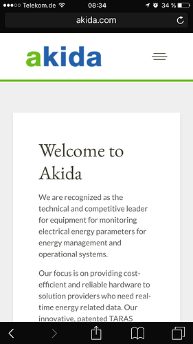

We have configured pi-hole to reply 0.0.0.0 as domain if it is blacklisted. We share this pi-hole server. For the other network it is working fine, all domains are blocked. On my end I can see that domains are piholed but I can still access these via browser. I have tried this on iphone, ipad and imac. When I try nslookup domain it correctly gives back 0.0.0.0.

iOS Safari screenshot (can access page)

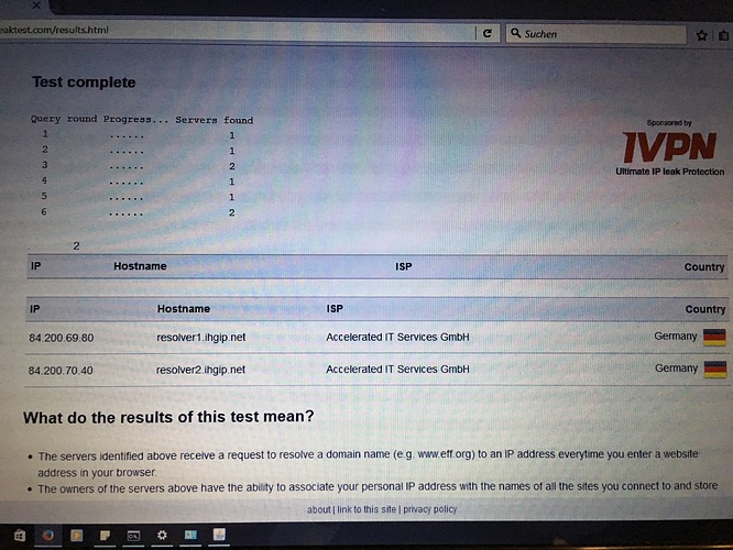

Can you try https://www.dnsleaktest.com/
Is that your pi-hole's IP? It should be showing only the pi-hole's IP there. :thumbsup:
no I do not know what IP this is.

Try setting your router's DNS to Google's 8.8.8.8. Clear your dnscache, and try the dns leak test in a private/incognito window. It should show 8.8.8.8 then.
yes, it now shows all the google DNS
One more thing to double check is if you have selected in Pi-hole Advanced DNS settings -> Interface listening behavior -> Listen on all interfaces, permit all origins (make sure your Pi-hole is firewalled!)
both IPs are from DNSwatch which is Pi-holes Upstream DNS Server
