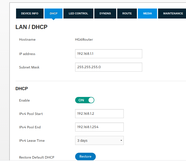

Is that all there is ? No LAN DHCP settings etc ?
Screenshots posted are for the WAN (Internet) side of the router and not the LAN side where Pi-hole and the clients are connected.
EDIT: ow you might want to redact your "Wan IPv6 Address" from screenshot above.
Turn off IPv6 and restart/renew and see if situation improves.
Above and disconnect/reconnect network for that Linux test client to have effect.
And dont configure your router to be an upstream DNS server for Pi-hole or you'll be creating a DNS loop!
You'll be missing out on individual client stats on the web GUI with this setup but for that, you'd really need a router with more options.

Is there anything here that I can change?
