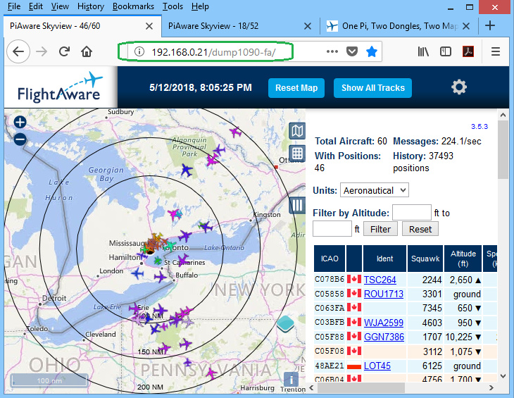

Is this discussion about maps and lighttpd of any help (I use the 1090-fa decoder)?
