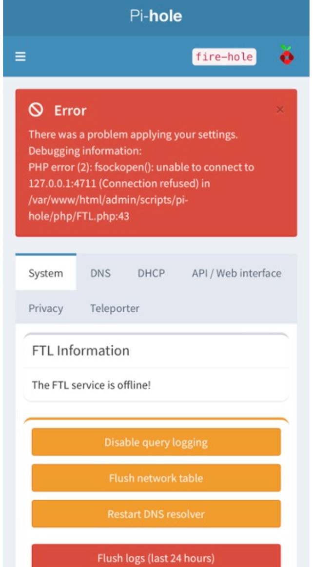

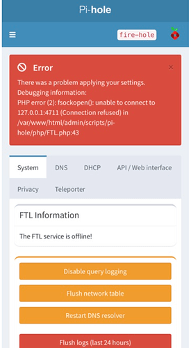

PHP error (2): fsockopen(): unable to connect to 127.0.0.1:4711 (Connection refused)
Seem to have the same error. at quite some time (eg 36h) I get the error from thread-starter. only cure seems to restart the system via web-interface or ssh-shell. the debug log afterwards is pretty fine,.. haven't startet while the error is happing, cause I am usually at work, and my wife at home, throws me hateful messages, why she doen't have internet.
Just writing to let You know, there are more people with this problem.
Next time the error happens I post a debug log.

Just now again this behavior.
Here is my token. and no I don't have apache installed and am not running on Armbian. But still the same error. So as Threadstarter assumes: doesn't have anything to do with apache.
I opened 4711 via UFW on UDP and TCP. Don't know If this is important...
But I would still be thankful, If anyone of You can help me solve it.
