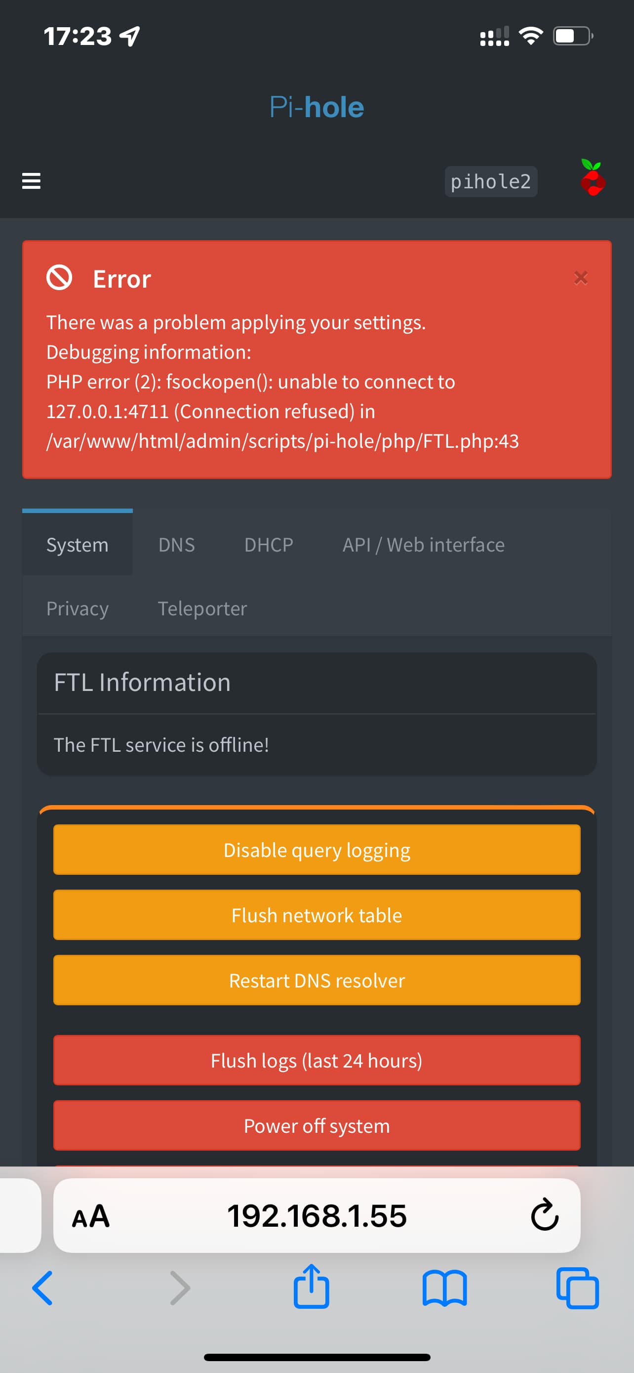

Every day or two I get an error and Pi-hole becomes unresponsive to DNS queries.
The error:
There was a problem applying your settings.
Debugging information:
PHP error (2): sockopen(: unable to connect to
127.0.0.1:4711 (Connection refused) in
/var/www/html/admin/scripts/pi-hole/php/FTL.php:43
I haven’t been trying to change settings though so I don’t understand what that’s about?
