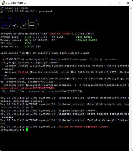

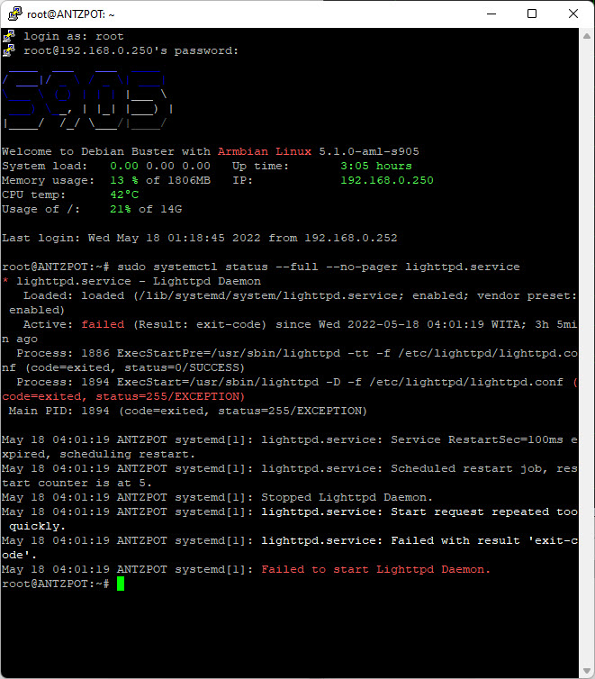

Hello,
More than a year I am running Pihole without any issue on Debian Buster with Armbian Linux 5.1.0-aml-s905. I don't know Linux. All this time I only do Pihole install and update by copy paste Linux command from tutorial website, nothing else
But since last update (Pi-hole v5.10 FTL v5.15 Web Interface v5.12) the DNS Server stop running and Pihole has error message "There was a problem applying your settings. Debugging information: PHP error (2): fsockopen(): unable to connect to 127.0.0.1:4711 (Connection refused) in /var/www/html/admin/scripts/pi-hole/php/FTL.php:43"
Already tried uninstall then install Pihole again. First fresh install running fine, but after 2 days the same error happen again.
Post this issue on Pihole Github - Bugs in Pi-hole v5.10 FTL v5.15 Web Interface v5.12 and suggest me to uninstall Apache2 which is interfering with Pihole lighttpd..
I did uninstall Apache2 but after that I am unable to browse Pihole web interface because lighttpd fail to start which looks like a configuration error.
And that is why I am finally in here because they suggest me the place to get help about lighttpd configuration error is in here.
Please help, thanks
