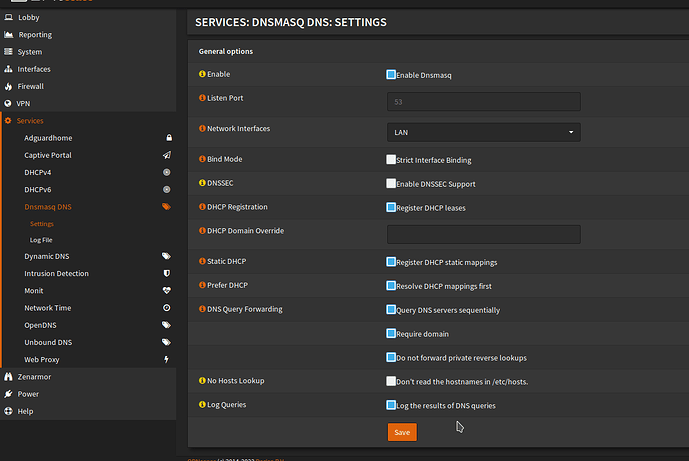

I have Dnsmasq DNS enabled.

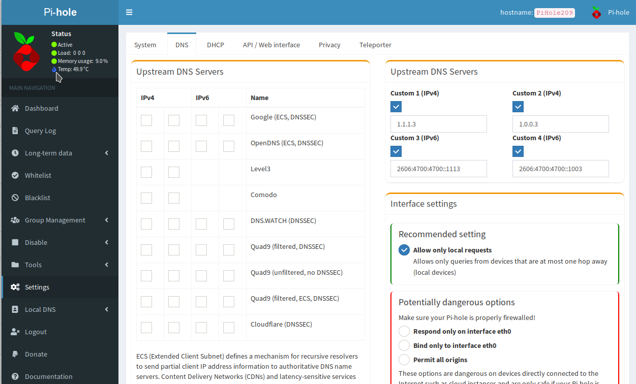

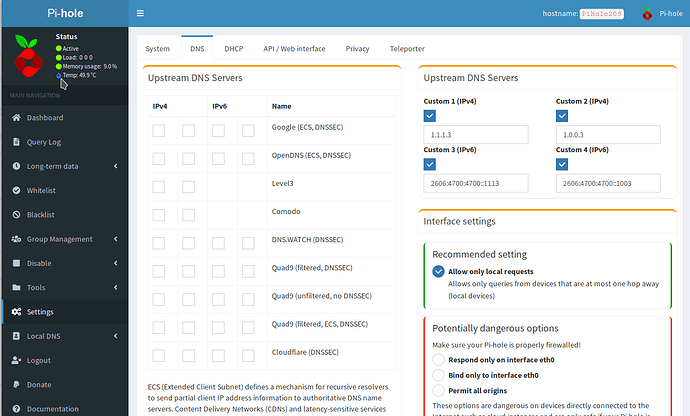

Upsteam in PiHole is set to cloudflare Family in Custom field in upstrem DNS server.

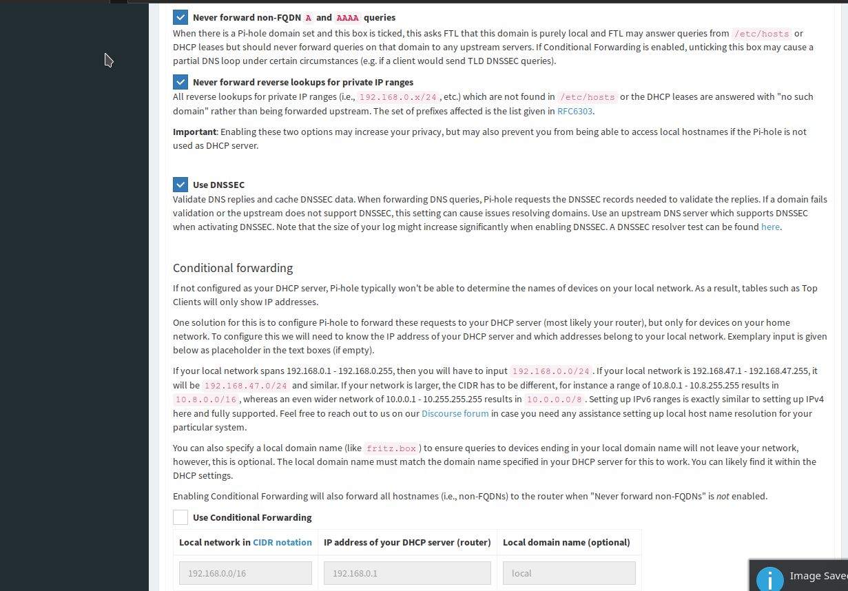

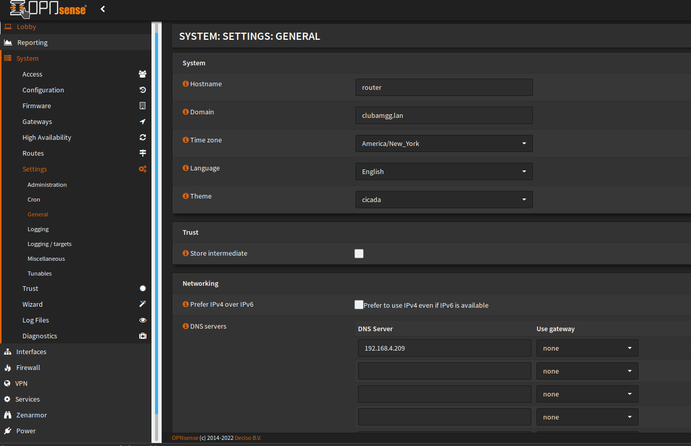

Here are some screenshots
What IP are you giving to clients for the DNS server? It should be OPNsense. Have you added the EDNS0/ECS to OPNsense's dnsmasq?
    add-mac
    add-subnet=32,128
    /usr/local/etc/dnsmasq.conf.d/edns0.conf
Edit: Pi-hole will use the upstream server to try to map client IPs to domain names. This is where unbound comes in to play. There's a second part of the guide that I haven't written yet but it covers unbound. CF Family doesn't know the information so there's no way to get that info to Pi-hole.
Your clients are able to use hostnames because they use OPNsense's dnsmasq directly and that daemon has the leases registered in its database.

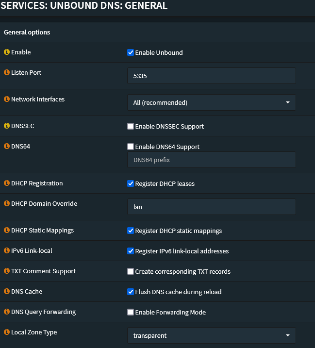

my unbound is also disabled since it conflicted with dnsmasq. i added that edns0.conf file and its contents look the same. is there something which needs to be done so that dnsmasq actually uses that file?

Set unbound to listen on port 5335 instead of 53. And set unbound to register DHCP leases so that Pi-hole can find the hostname to IP mappings.

ok thank you for replying. , i had already set up unbound as per your earlier screenshot. but not sure what to do with it now. set my opnsense IP as the "Custom 1 (IPv4)"? can i add a port to that part of that entry? 192.168.0.1:5335 or 192.168.0.1#5335 ?
Set the unbound ip and port in Pi-hole as the upstream. That should be the only change you need to make.
ok i've just added it as 192.168.0.1#5335 and disabled the other upstreams and conditional forwarding. but i'm not getting the local host names being resolved in the logs. external name resolving is still working though
Pi-hole queries for the names on a schedule, if you want to kick that process off manually then go to the Pi-hole admin page > Settings > Flush network table. (Or Restart DNS resolver). Then you should see the process happening on the Query Log with pihole making a series of PTR queries to OPNsense's unbound daemon.
