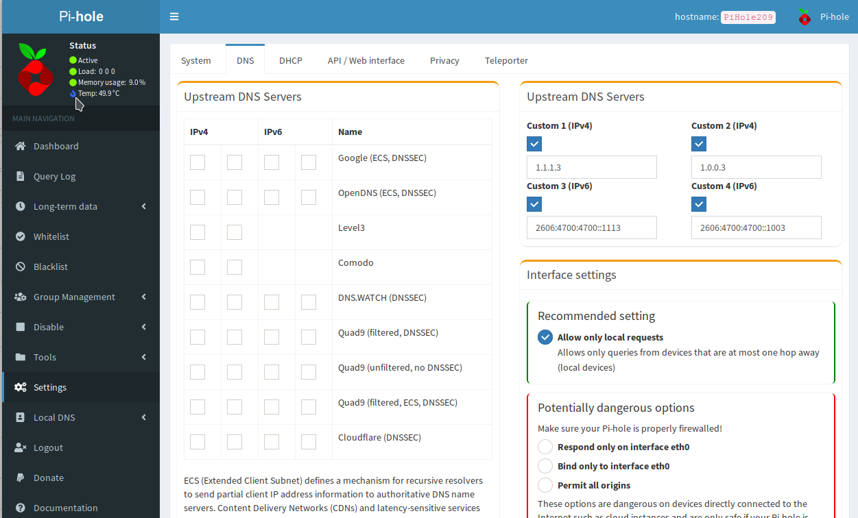

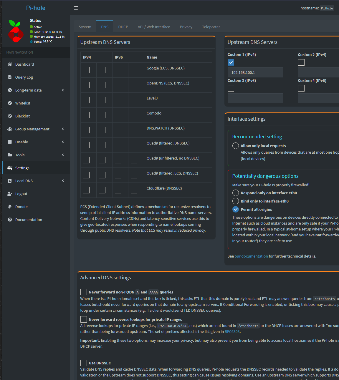

I think the way to configure a backup DNS resolver is to use the fields in Upstream DNS servers called Custom 1, Custom 2 or check the preconfigured ones like Google, Cloudflare ...
https://discourse.pi-hole.net/uploads/default/original/3X/a/0/a045164feb79b41712a44eb4d3f4732c553e7431.png
If you want backup in case Pihole is unreachable, use the fields on the bottom called DNS servers,. but I think the clients might start using the backup DNS even when Pihole is available, not sure what the reason is for that,

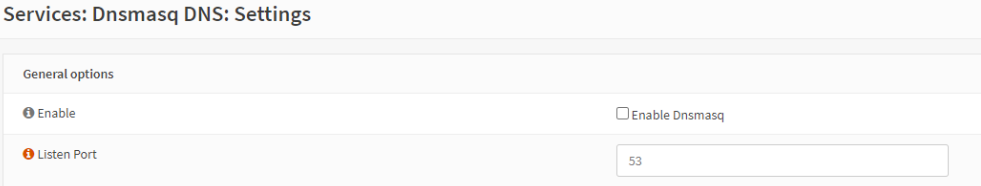

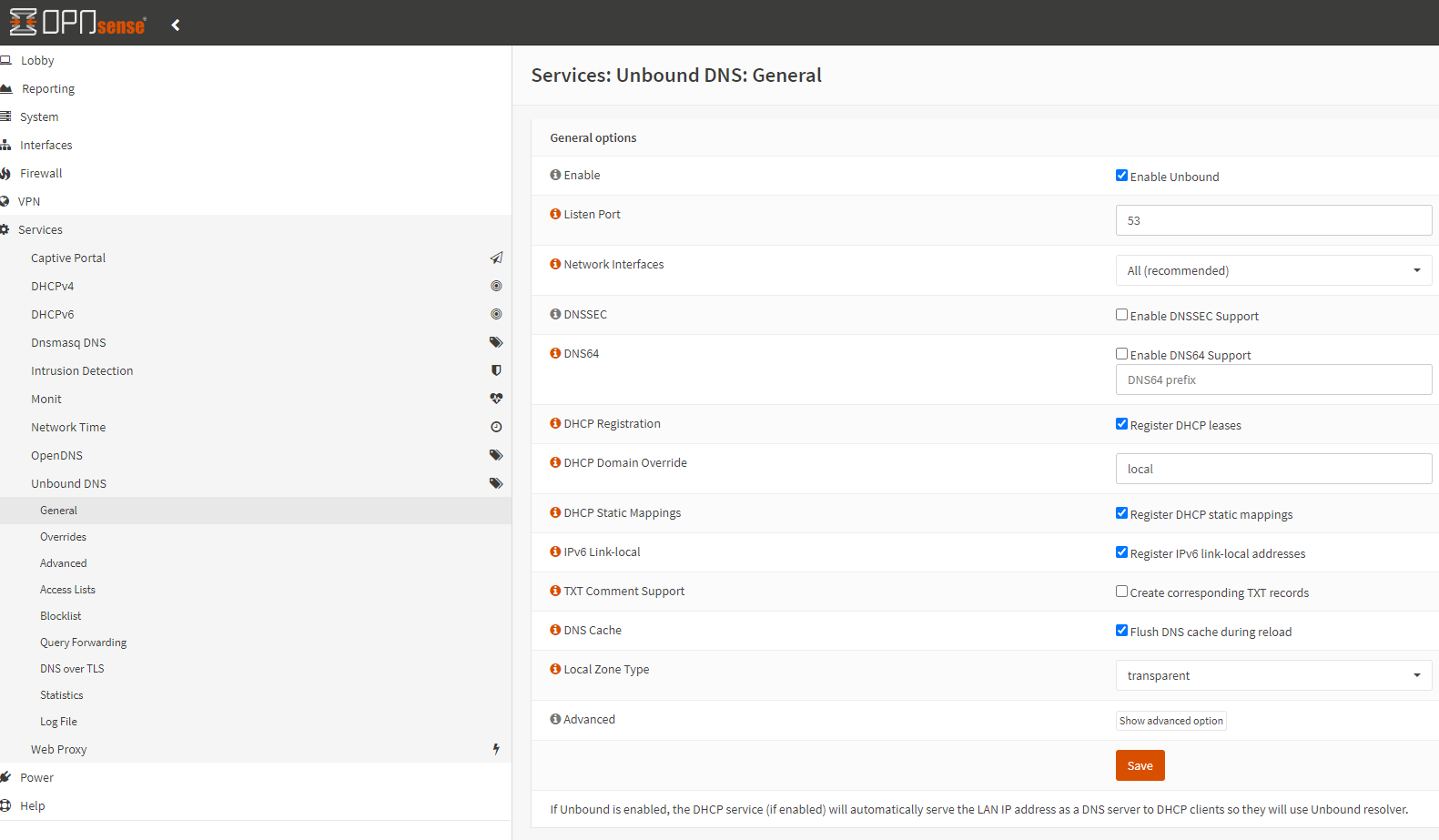

So I disabled DNSmasq from my OPNsense Router, I set PiHole as my DNS1 server in DHCP and set DNS2 to be OPNSens router (Unbound).
It is working, when there is DNS query it goes through PiHole, if PiHole block it than it is blocked and client do not query other DNS servers. If it is not blocked it goes to Unbound where if its local device it is resolved to local IP and if its remote than it is resolved by Unbound.
Blocking was tested by trying to ping domain that was marked as blocked in PiHole query log, in respons I got: "Ping request could not find host fp.msedge.net. Please check the name and try again."
In case PiHole is down, clients query Unbound directly (it adds little delay but it is working).

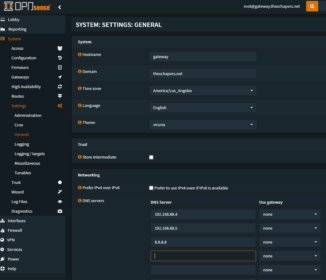

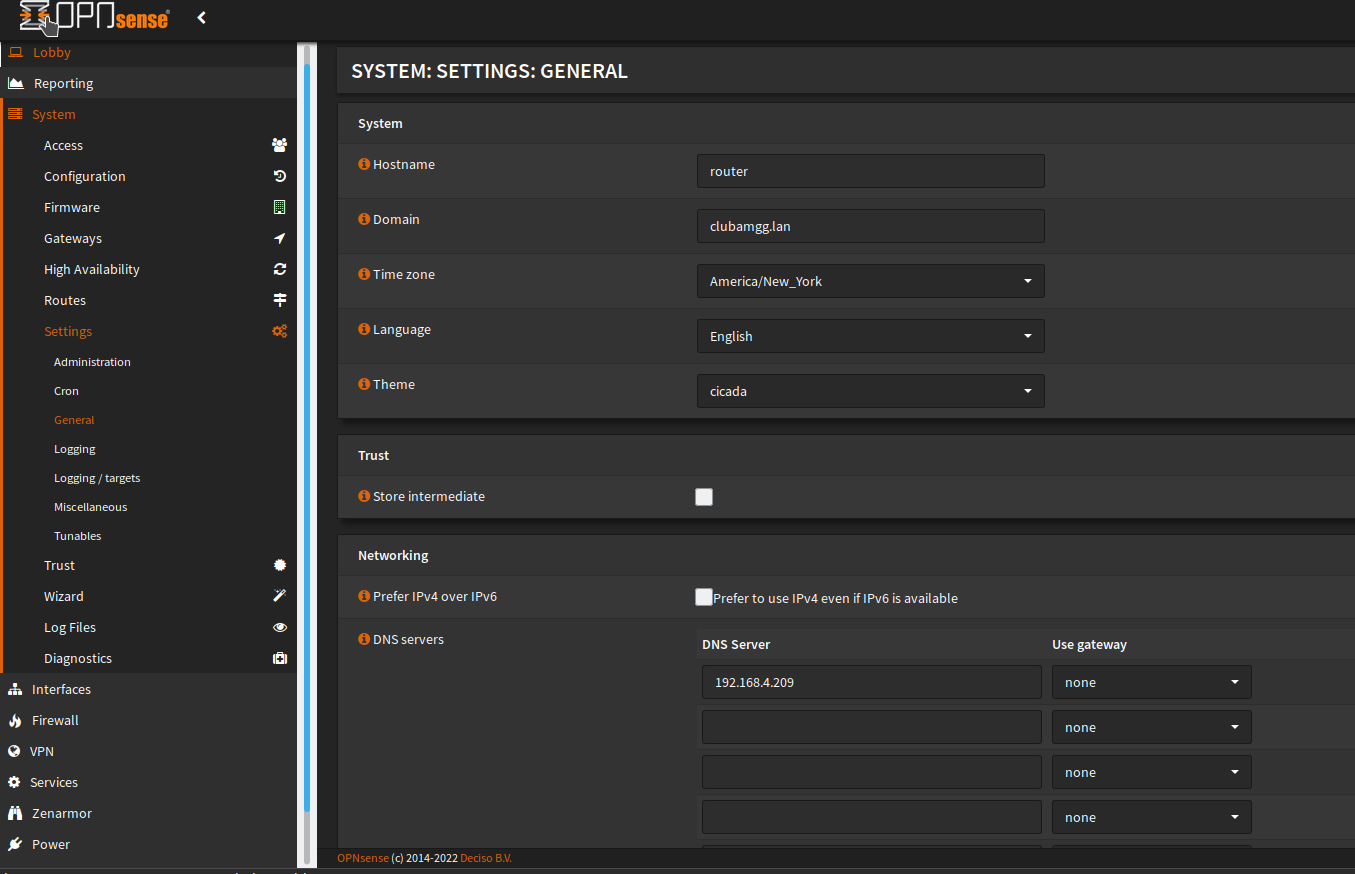

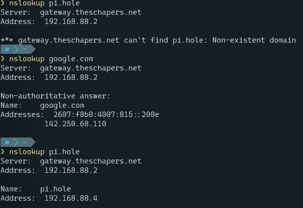

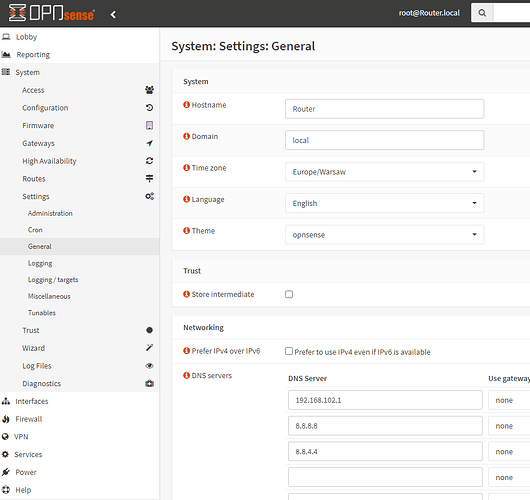

Sure, add the additional DNS to the General settings:
Pi-hole is offline for the first nslookup and pi.hole doesn't resolve, but google.com does via the backup. Then after bringing Pi-hole back up I get a response for pi.hole again.
Screenshot 2022-04-12 154520
That is where you will have clients bypass Pi-hole. You want only the OPNsense IP there.

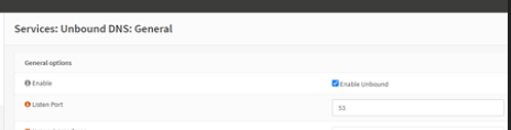

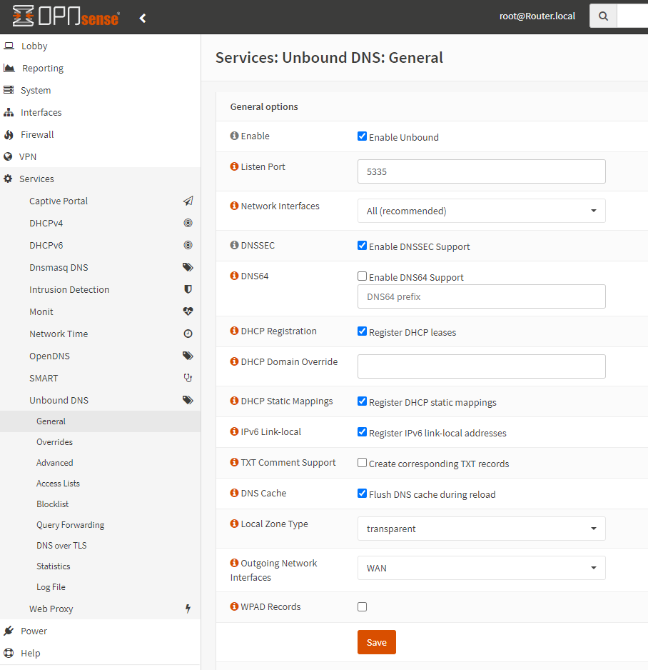

You can't have both on port 53, that's why the guide shows that dnsmasq is on 53 and unbound is on 5335 with Pi-hole using 192.168.100.1#5335 as the upstream.

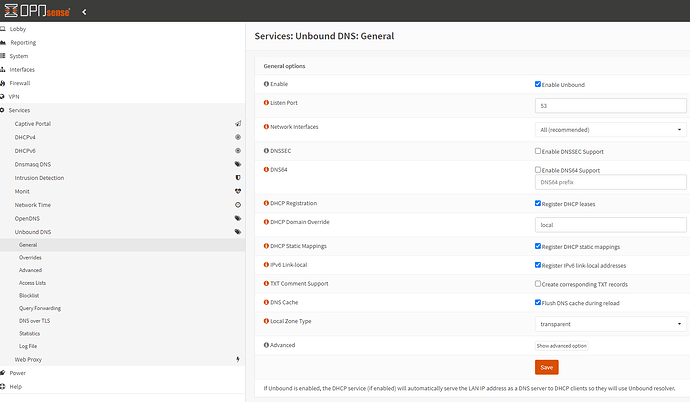

Yes I know, when I was using setup from Guide I had Unbound on 5335 but right now I disabled DNSmasq so I switched Unbound to default 53. Now I have Client->PiHole->Unbound->world,
If PiHole is down then Client uses secondary DNS (from DHCP) which is Unbound so it looks like this:
Client->Unbound->world
Unbound=OPNsense router
Both my local and external DNS names seems to be resolved correctly:
DNSSEC - yes, enabled it yesterday, and verified it is working, also tuned Unbound a bit :slight_smile:

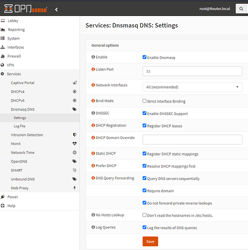

So I tried configuration like you described previously (same as in Guide + Unbound + 8.8.8.8 in System->General->DNS) but unfortunately it doesn't work. Not sure why, maybe because my PiHole is on docker so host isn't physically down, container and port are down but server is still up.

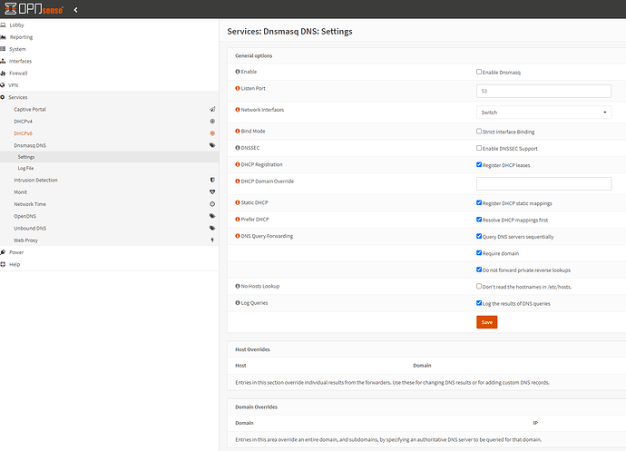

Here is my config:
When PiHole is down I get:
When it up:
192.168.100.1 = OPNsense router
192.168.102.1 = Server with docker running PiHole
Any idea how to make it working? Maybe use a macvlan in docker so PiHole would have "own" IP address?

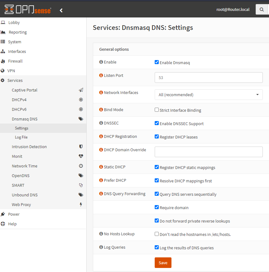

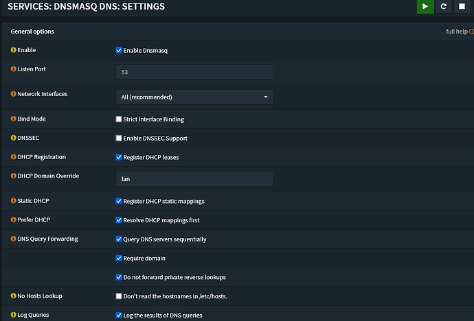

Make sure you are not discarding blocked responses from Pi-hole:

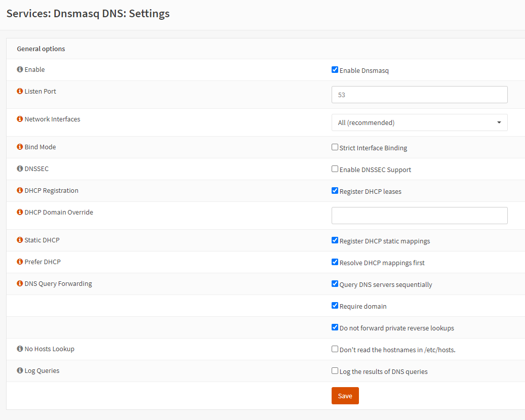

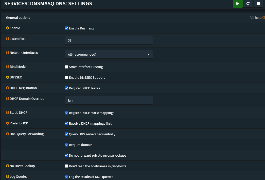

Also disable DNSSEC on the dnsmasq service, we want Unbound to handle that.
This is set like in Guide
Oh, you are completely correct.
You do want that disabled. Sorry about that.

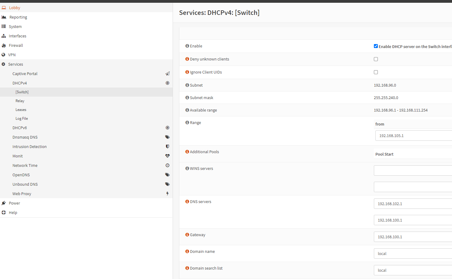

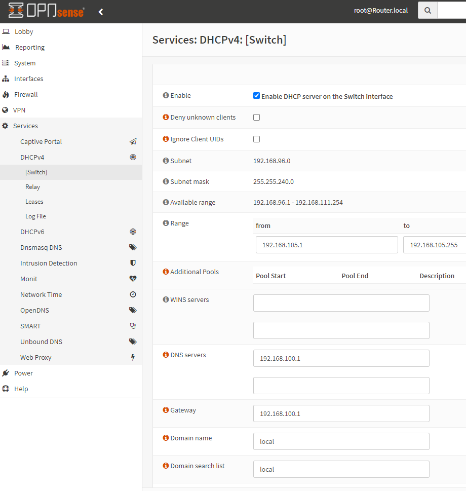

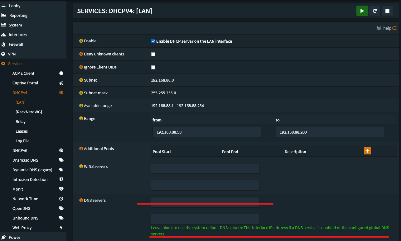

Where I think you have an issue is looping the DNS server, make sure that the DHCP server is not handing out a DNS server address.

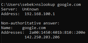

Unfortunately removing DNS servers from DHCPv4 did not help. After turning down PiHole nslookup is failing.

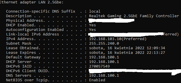

What does an ipconfig /all show for that clients DNS servers?

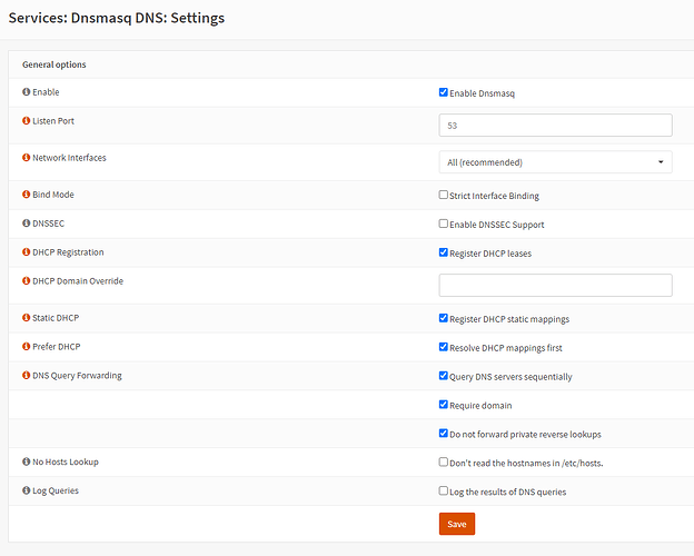

And did you disable DNSSEC on the dnsmasq service?
ipconfig /all
I did renew after changing it in DHCP settings, but DNS IP is still the same 192.168.100.1 (OPNsense router).
Yes

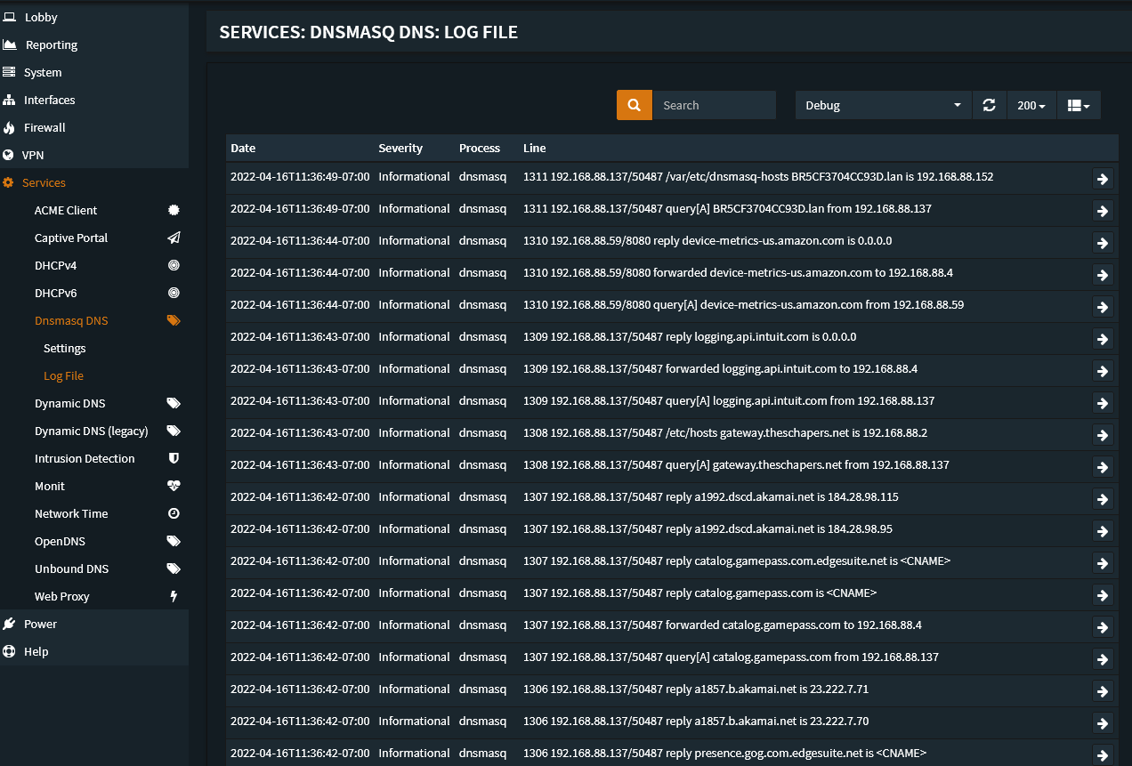

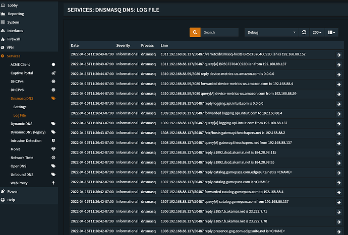

Okay, then we'll have to take a look at the opnSENSE logs to see what is going on...
First let's look at the dnsmasq log at the debug level.
