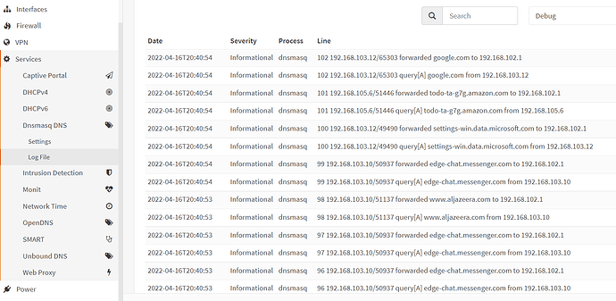

Right now I'm on different machine 192.168.103.12 (previously on .10), so first lines in log are from nslookup that failed
PiHole off:
Okay, that's got some interesting parts in it.
It's still trying to use Pi-hole but there is no response back, which is exactly what we expect.

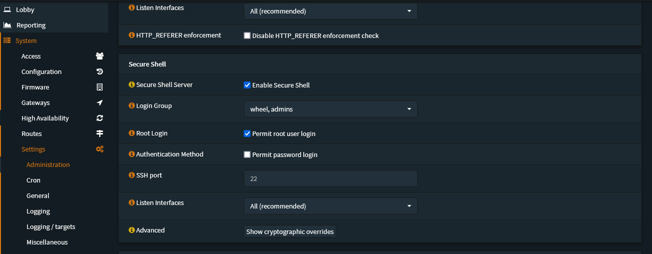

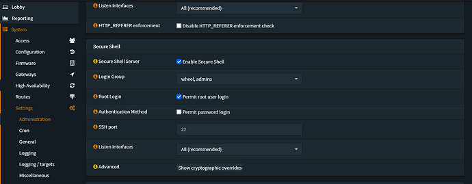

Do you have ssh
service enabled for opnSENSE? I'd like to check a few things at the console shell...
Yes I have (but only locally)

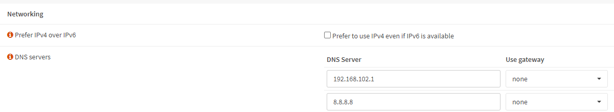

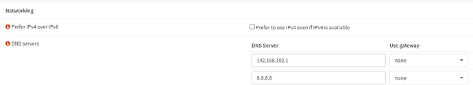

Ah, I think I've found it. Without Query DNS servers sequentially
everything works. But it should be following order so I'm going to do some digging.

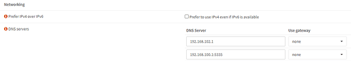

to prevent loops. And as you saw, there is no place to put a port with /etc/resolv.conf
. (That's what opnsense changes when you add DNS servers to General settings.)
