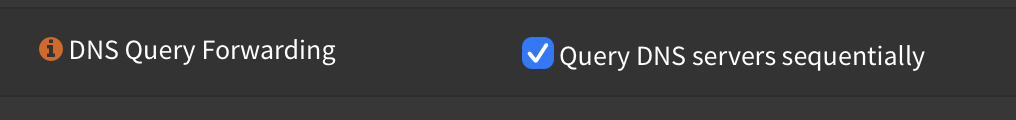

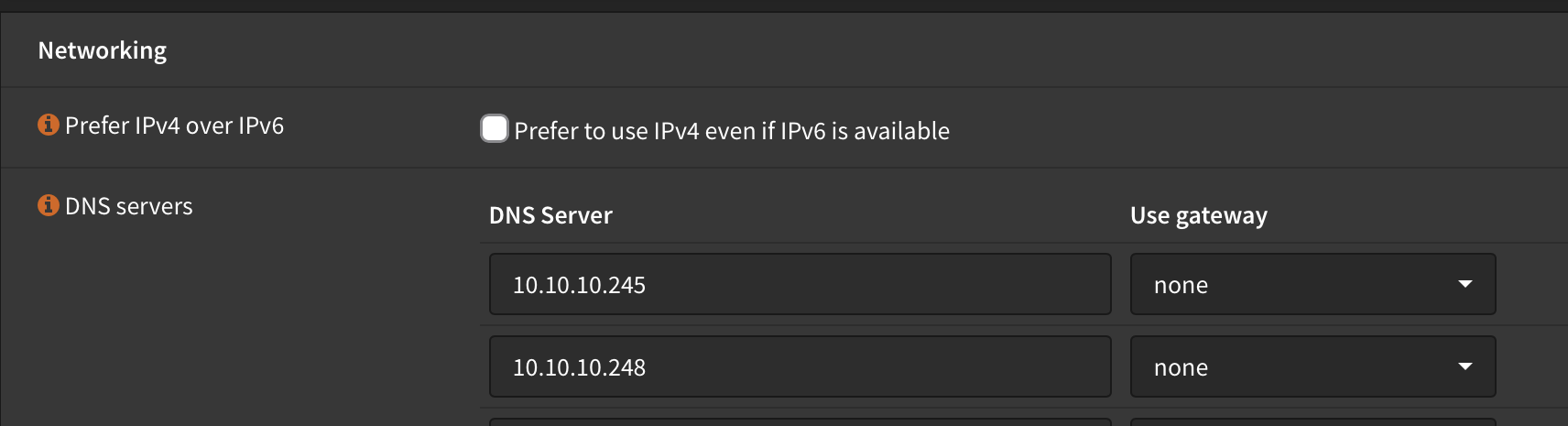

Following this guide — https://pi-hole.net/blog/2021/09/30/pi-hole-and-opnsense/ i had setup Pi-Hole and working perfectly, with the host name appearing in Pi-Hole. This has been setup this way for a week or so. Now i want to add a second Pi-Hole into the network to act as failover for the first one. So i setup the other Pi-Hole have it syncing with the first to keep blacklist/ whitelists etc all in sync. Now i thought to add this to OPNSense i would just enter the second Pi-Hole IP address into OPNSense as below, and setting this in Dnsmasq.

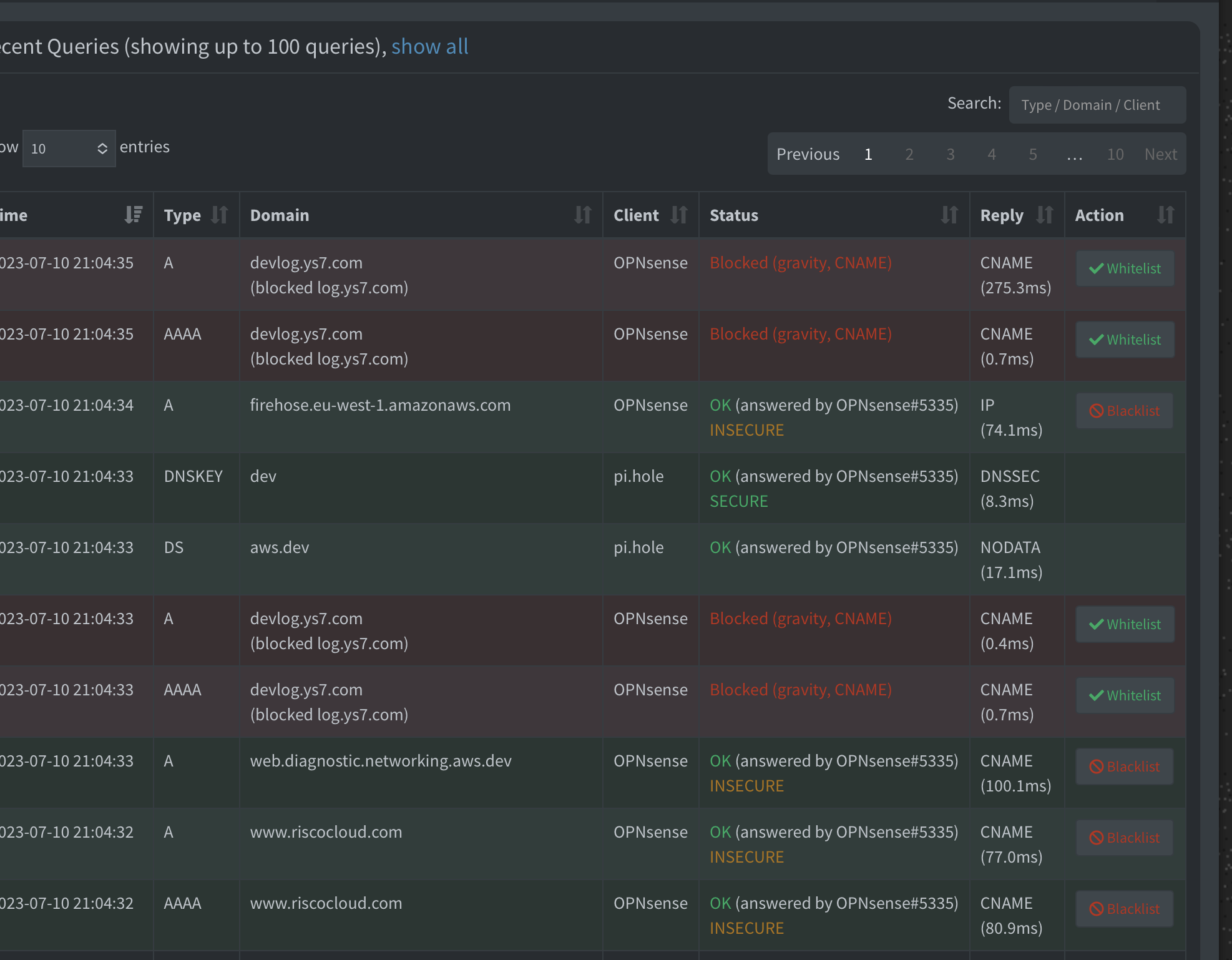

When i purposely take the first Pi-Hole down it doesn’t seem to failover to the other Pi-Hole, which does tie in to this thread I’ve been reading - OPNSense + PiHole - #26 by DanSchaper So of course i removed edns0 from Dnsmasq and tried using the conditional forwarding on Pi-Hole which is working as expected and does now failover however in Pi-Hole the client is always showing “OPNSense” or “pi-hole” rather than the device host name or even IP address see below
I’m copied all settings in Dnsmasq and Unbound (OPNSense) and Pi-Hole that i can see in all guides but nothing will make the host names show in Pi-Hole despite adding edns0 back in to Dnsmasq but then of course i lose the failover to the other Pi-Hole.

OPNSense - 10.10.10.1
Primary - 10.10.10.245
Secondary - 10.10.10.248
