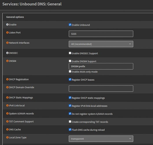

Oh good to know on the port, maybe that is part of the problem, I will switch it to 5335 and give that a shot, conditional formatting was disabled when doing the log report

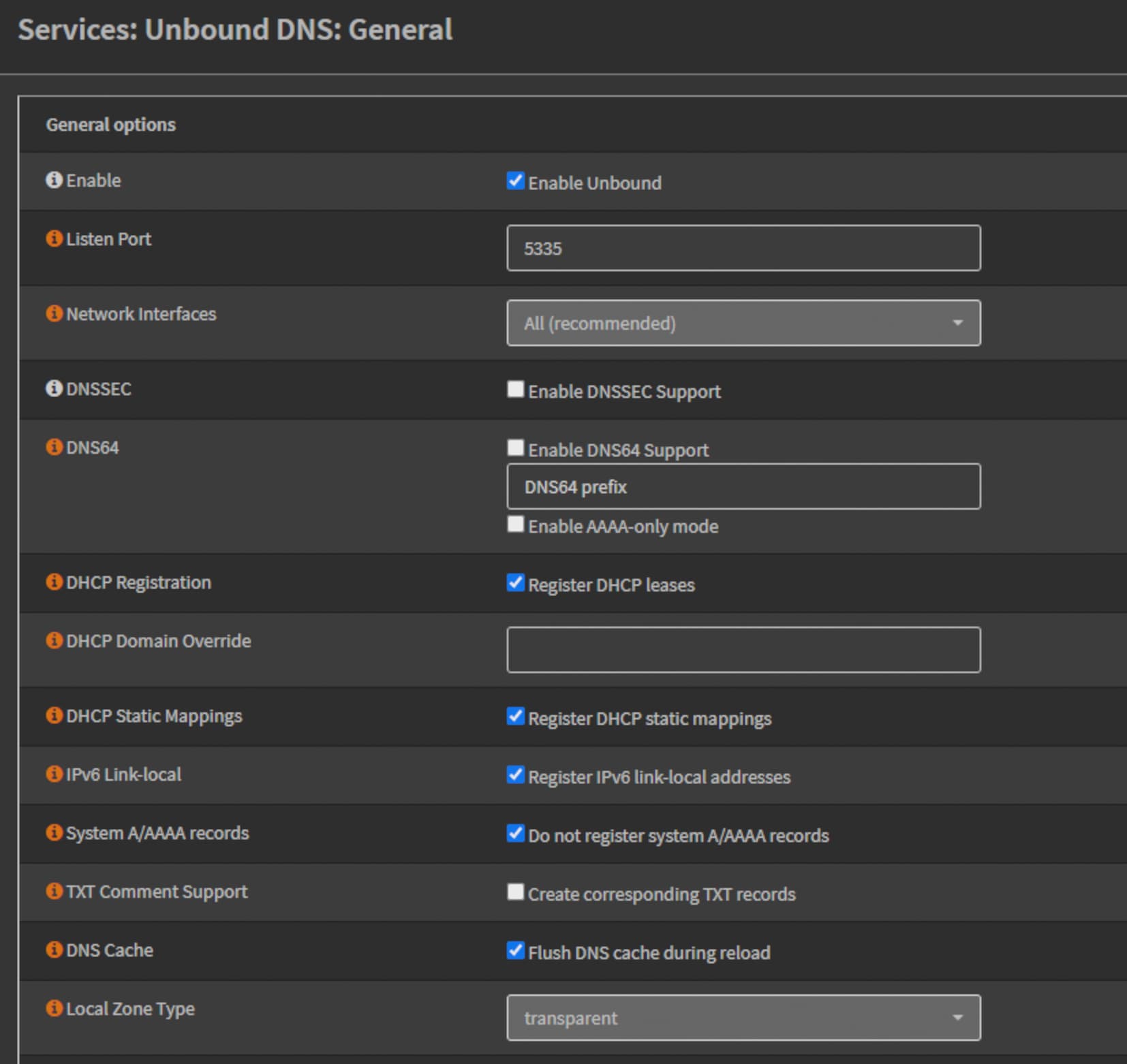

Ok so I have changed to port 5335 on unbound but that is not doing anything for me.
I have updated the pihole debug file located here: https://tricorder.pi-hole.net/3RQ9ssDF/

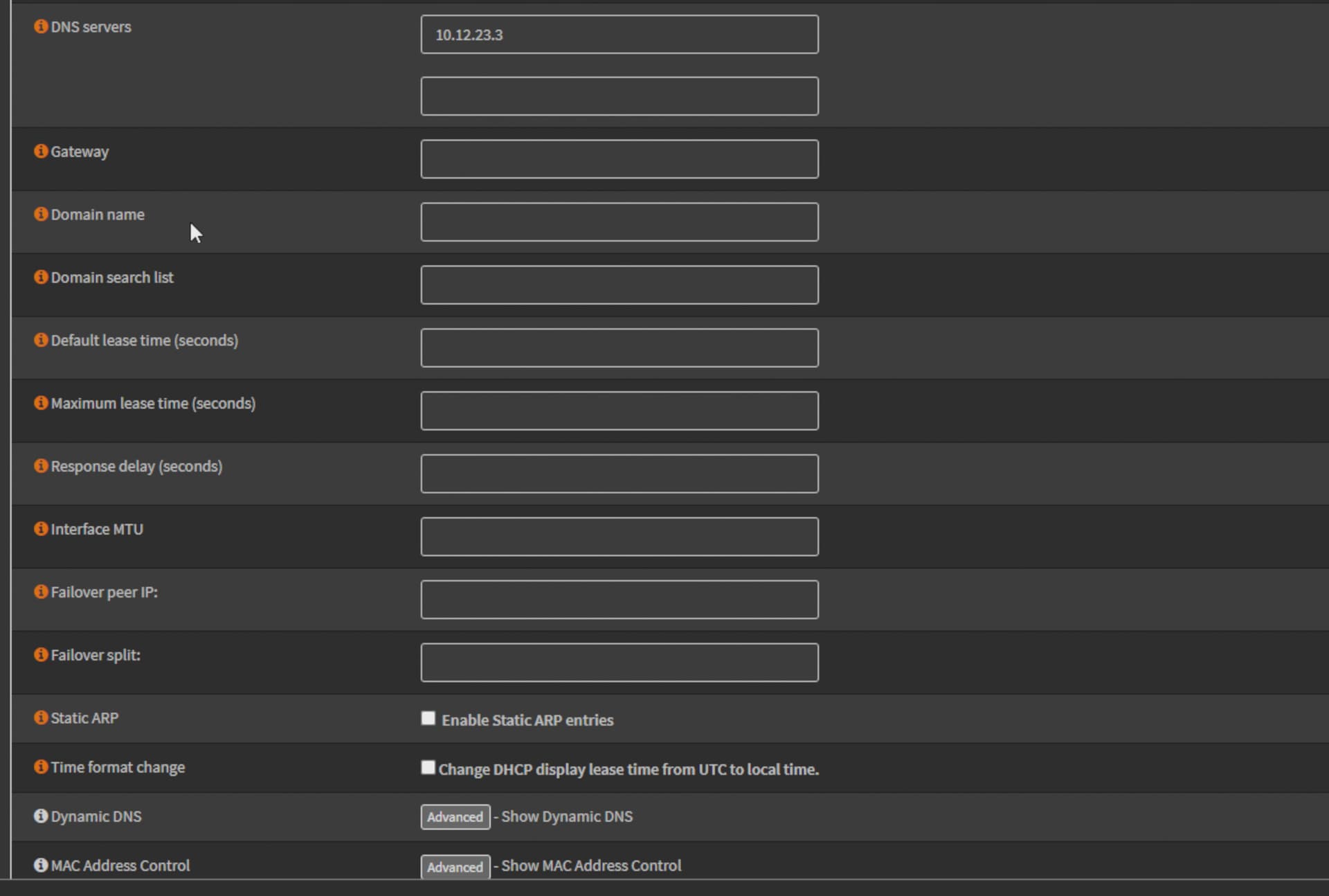

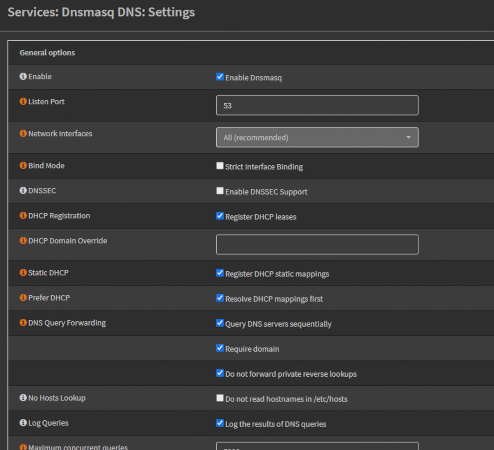

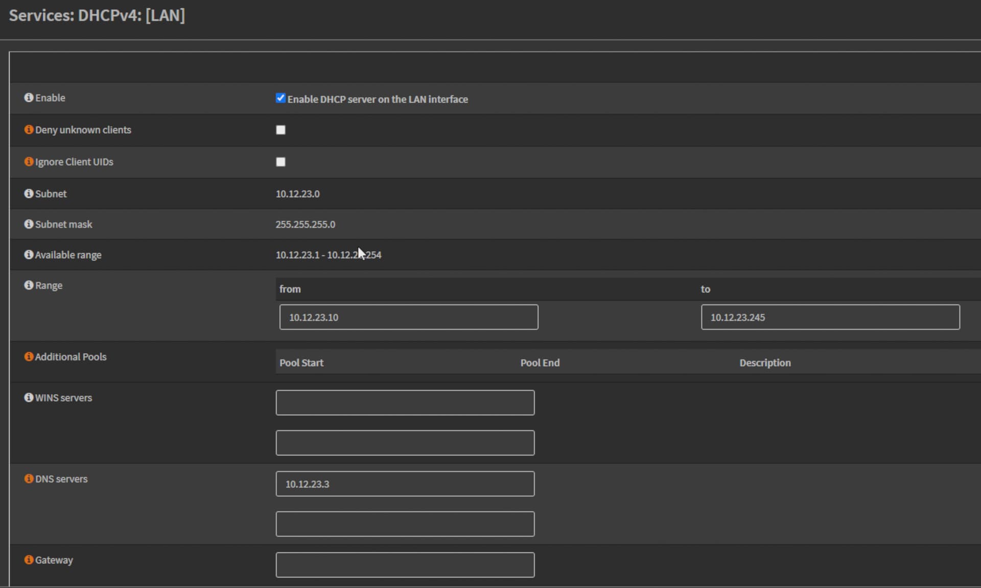

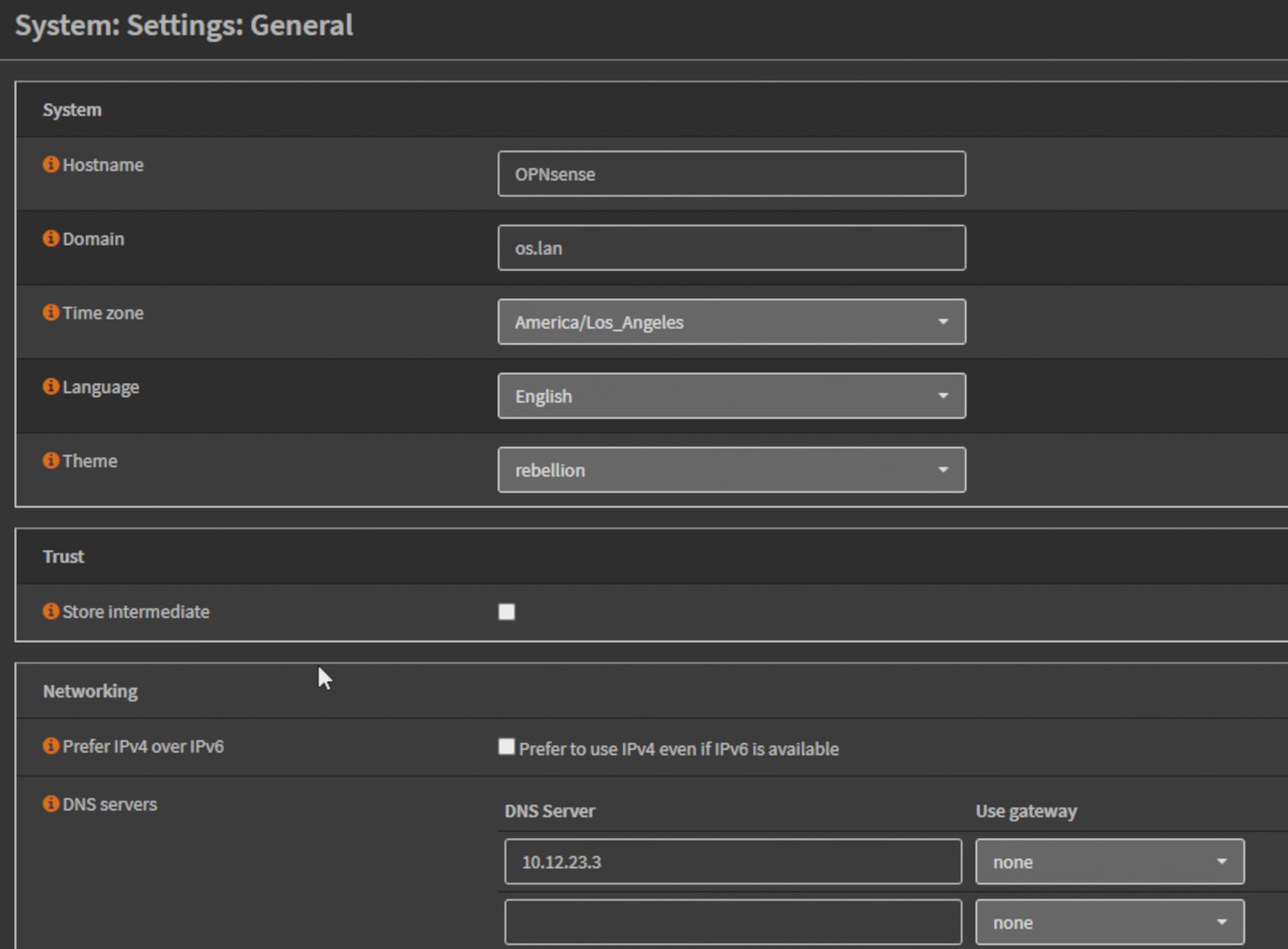

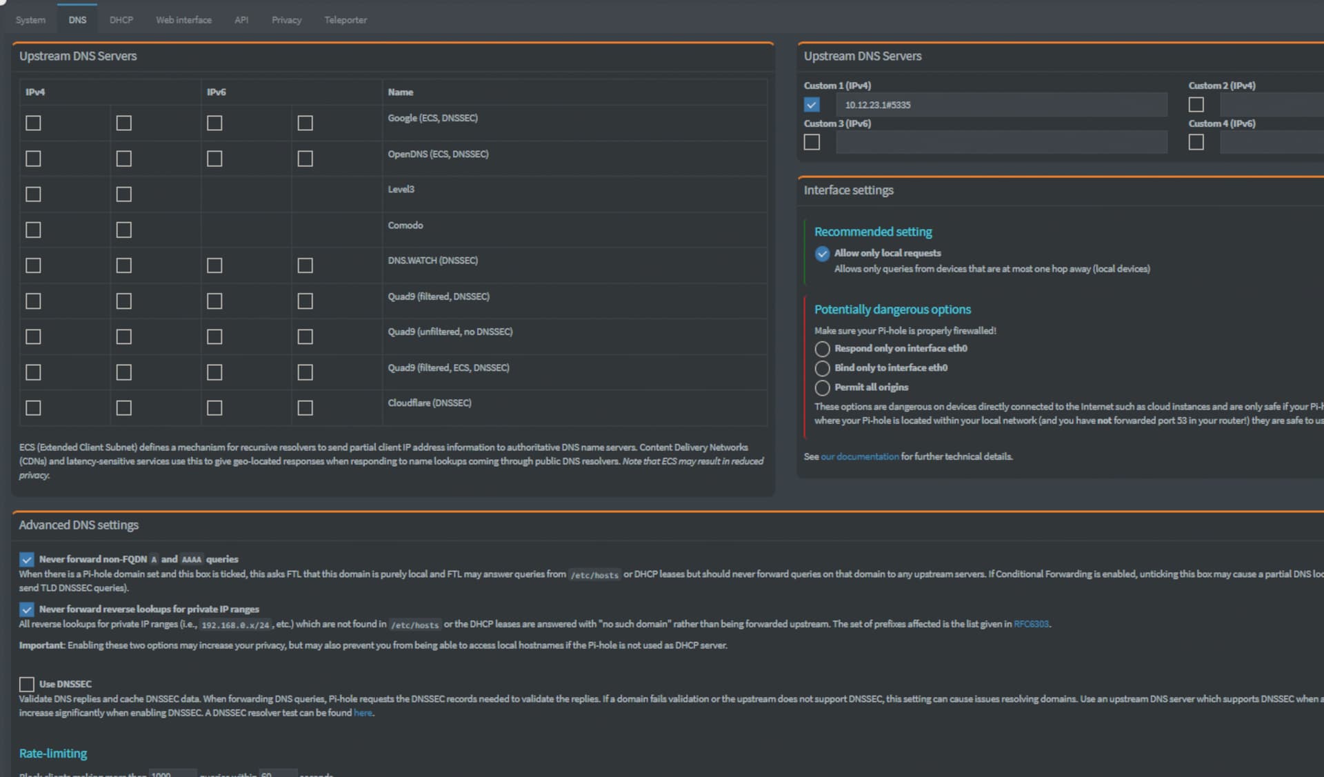

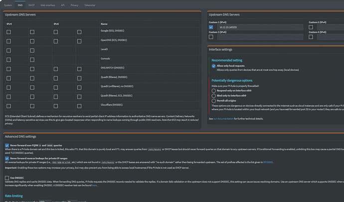

I have also taken screenshots of all of the relevant settings I think within opnsense, if you need me to verify anything else let me know
How do you have unbound configured to listen for traffic? On the loopback interface, or via an external IP?
Pi-hole is configured to communicate with unbound as follows:
PIHOLE_DNS_1=10.12.23.1#5335
Is unbound running at that IP and configured to listen for traffic on that port?
Unbound is running with opnsense so it should be the same IP as opnsense I believe, and I have set the listen port to 5335
I can confirm it is working though, I can see that as I browse the web the Unbound queries continue to go up, so I would assume it is working, I can see individual requests which are correct for my browsing activity

I have DNSmasq setup on port 53 currently, and I setup the edns0.conf file which successfully worked prior to having unbound setup. Once I added unbound to the equation hostnames stop coming across to pihole altogether.
I would normally just enable Conditional Fowarding and call it a day, but the issue I have is more with OPNsense than PiHole in that, hostnames are not coming across anywhere so I am trying to solve this issue because I think it will solve my other issues since those were also working prior to using unbound.
