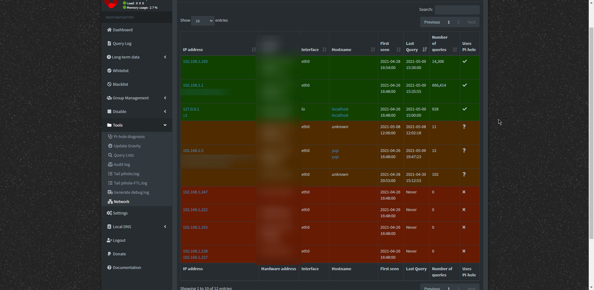

i put my device names in /etc/hosts along with their IP
I'll look into this ty
The specified directory '/etc/hosts' is not valid

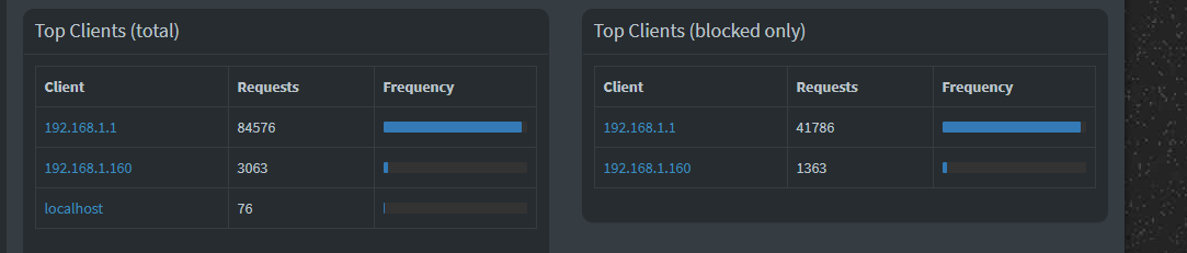

My pihole settings are on default DHCP server isn't enabled on pihole will i need to enable that.

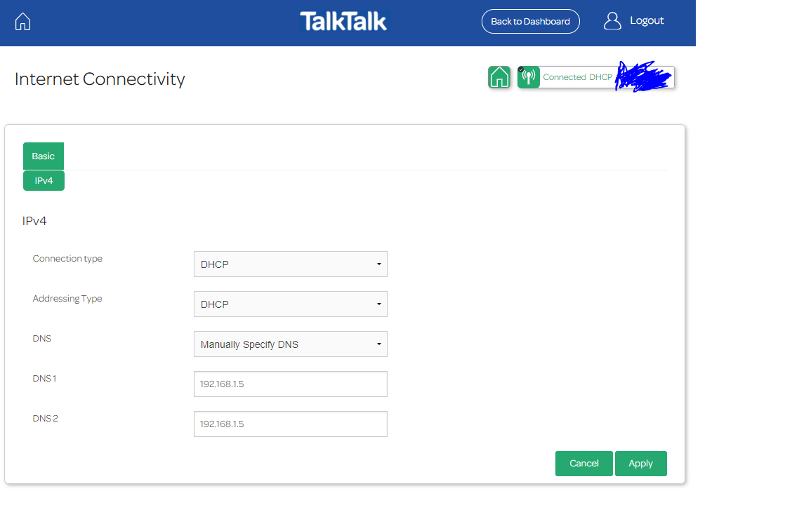

Talktalk fibre router i'm with talk talk and in the UK
Does your ISP support IPv6 upstream:
If not, I would disable anything IPv6 related on the router LAN side to avoid those headaches.
EDIT: ow and when configuring conditional forwarding, make sure your router is not configured to use Pi-hole for upstream DNS resolution (WAN/Internet DNS settings) or else you might create a DNS forwarding loop that is not desired.

Router handles DHCP, DHCP is off on the pi and IPV6 isn't supported with my ISP.
