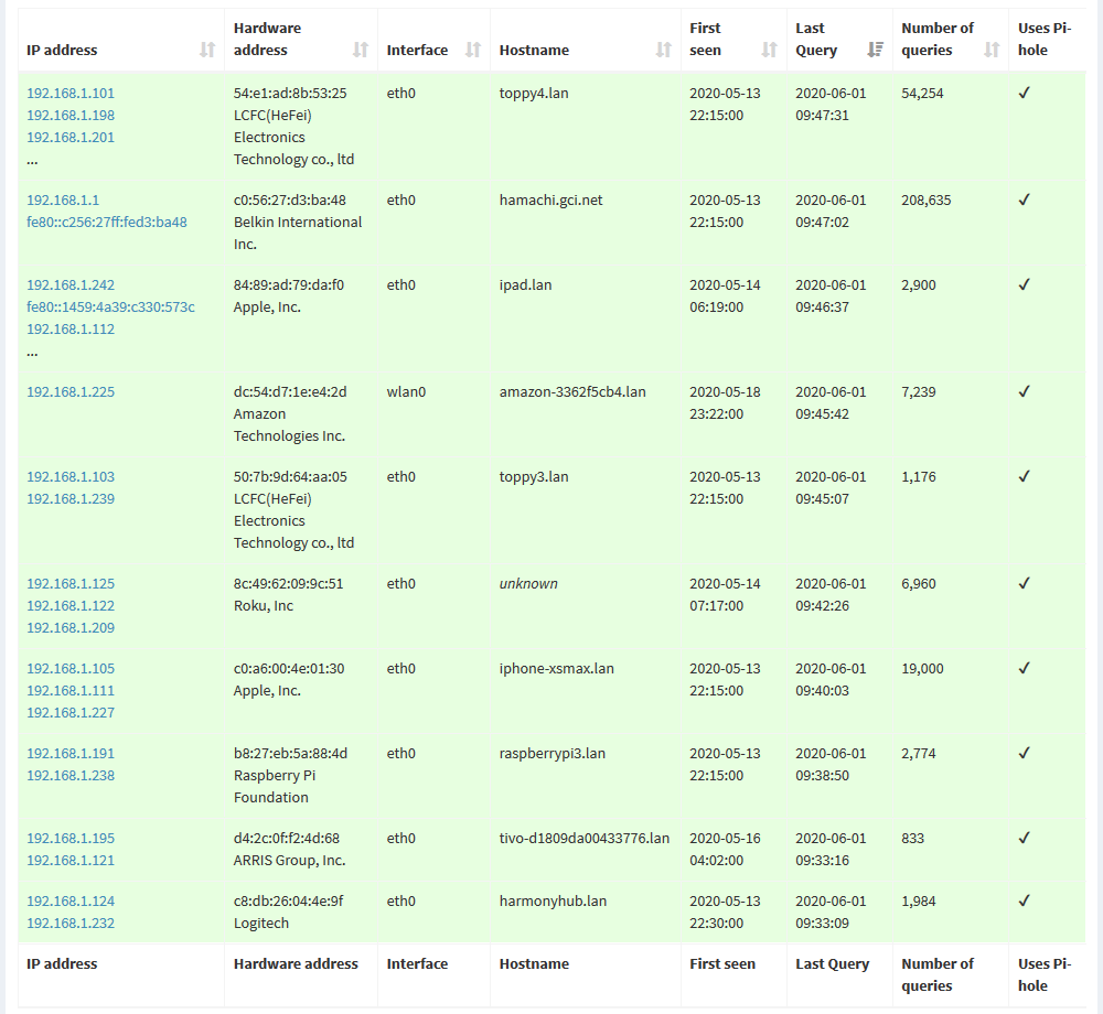

The network overview page of the admin console appears to list the devices connected to the network being monitored by Pihole.
Some of the devices in my listing have two IPv4 addresses, some have one, one has three.
Can someone explain why there are multiple addresses?

Thanks, but I don't think lease duration (24 hours) is the reason because I have reserved IPs on the router for all connected devices. And the second IPs are widely separated from the reserved IPs. For instances, the reserved IP for one device is 192.168.1.111; the second (DHCP-assigned) IP listed in Pihole for that device is 192.168.1.227. That's just my thought.
Please post a screen capture of your network page - in this forum you can copy and paste an image directly into a reply.

If you look at the hostnames I see two different local domains in your hostnames, *.lan and *.gci.net. Maybe this indicates two concurrent DHCP servers (or misconfiguration?)

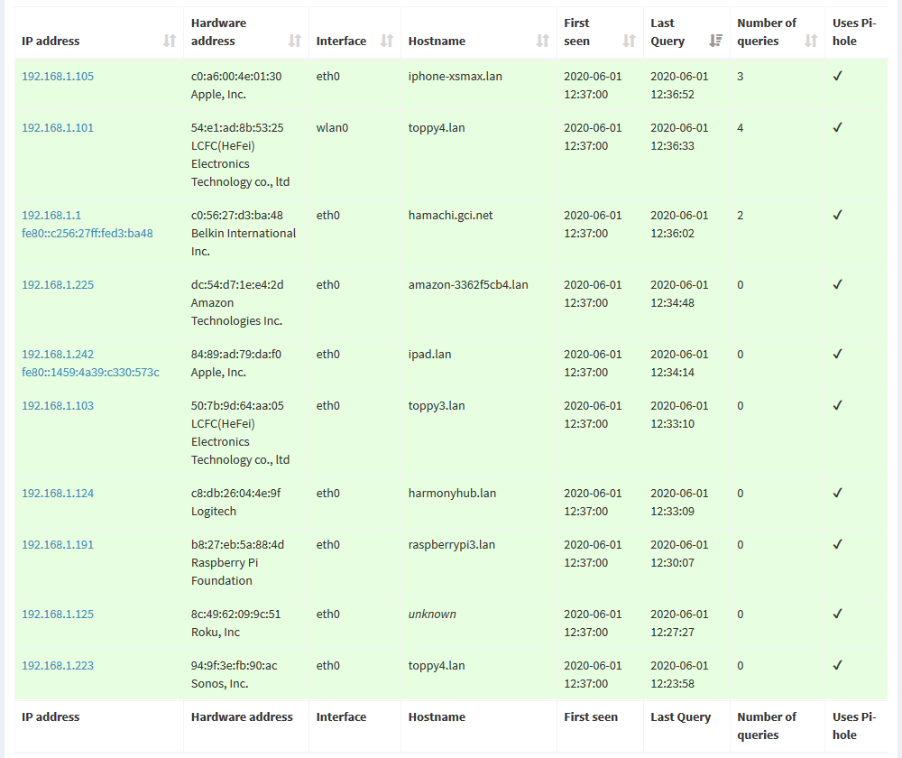

I think I've resolved the two DHCP server problem. Here's a recent network scan from pi-hole
Following the advice in your last post, I ran ipconfig on my laptop (192.168.1.101) and it correctly reported that 192.168.1.192 is the DHCP server. But pihole reports two additional IP addresses for the laptop: 192...198 and 192...201
Why is that happening??

Did you flush your network table after you did the switch? Maybe the table is still full of "old" entries. Try Settings/System/Flush network table and see if more than one IP gets assigned to the devices when pihole is the only DHCP server.
yubiuser--you are the man! Flushed and one problem solved.
