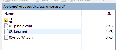

I agree with @Bucking_Horn you need to do some research in the volumes and mounts. There are specifics depending on what platform you are running docker on. I have Docker on both a Synolgoy NAS and Raspberry Pi's and using this volume map which will leverage the directory where the .yaml file is located:
volumes:
   - './etc-pihole/:/etc/pihole/'
   - './etc-dnsmasq.d/:/etc/dnsmasq.d/'
When I check the directory etc-dnsmasq.d I find these files:
