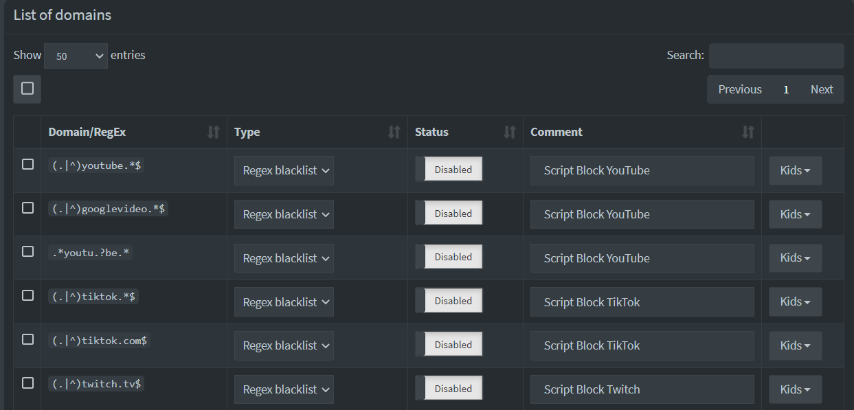

Understand PiHole was not intended for parental control but seemed to be the easiest way to prevent access to social media sites during school days.
The idea is to have a cron job run a script twice a week. Once on Monday morning and then on Friday afternoon. This script would enable or disable the gravity database blacklist table based on the comment with the word "script".

gravitydb="/etc/pihole/gravity.db"
# Enable/Disable blacklists with script in comment.
pihole-FTL sqlite3 ${gravitydb} "update 'domainlist' SET enabled = '${enabled}' WHERE comment like '%Script%';"
pihole restartdns reload-lists

All seems to work, as the scripts are being triggered correctly and modify the DB.
The issue I am having is that PiHole, even though I have the blocklist enabled through the script - seem to ignore the changes until I manually restart the DNS Service or manually run *pihole restartdns reload-lists*.
