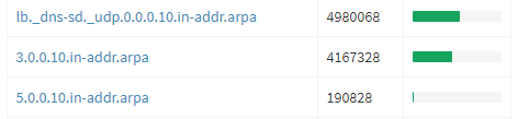

Millions of PTR Queries in-addr.arpa
There are literal millions of queries. How do i solve this?
Edit: TURN OFF Conditional Forwarding, that seemed to be my issue
The first is a Bonjour request (Apple uses this). The second is likely related.
Do you have conditional forwarding enabled? That can cause a lot of circular traffic.
I did have it enabled, I continued to look for the culprit and figured that it sounded like it was.
Edit: Queries dropped from 8000 to 200 after disabling it. I'm thinking that was the problem.

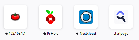

I can tell you that if you have a chromium browser running, chrome, firefox, you know 90% of all browsers run chromium. If you have your pi-hole login as a shortcut on your home page and it is set to your internal dns instead of IP it will create SOA request continuously to your pi-hole. This will make your "blocked percentage" of request go way down like this.
It looks like this on your pi-hole

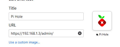

If you tail your ftl file you will see it is being generated from the devices you have that link on your start page. If you edit the shortcut from http://your.dns.net/admin to the ip address it fixes this issue.
