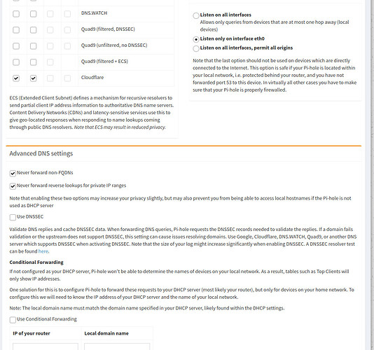

Do you have conditional forwarding enabled?
Is this a setting I should look for on my router or in the pihole web admin page?
Web admin page in the settings > DNS menu.
I do not have conditional forewarding enabled

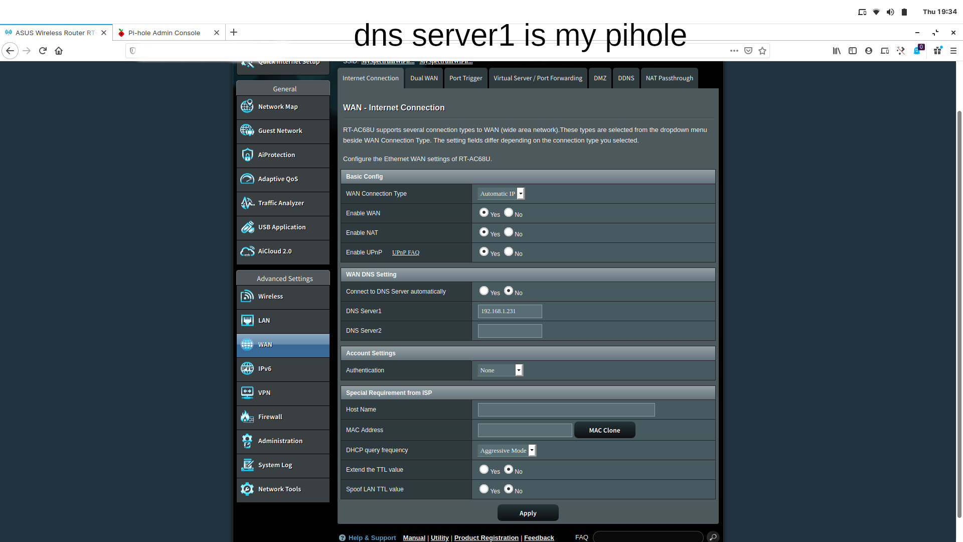

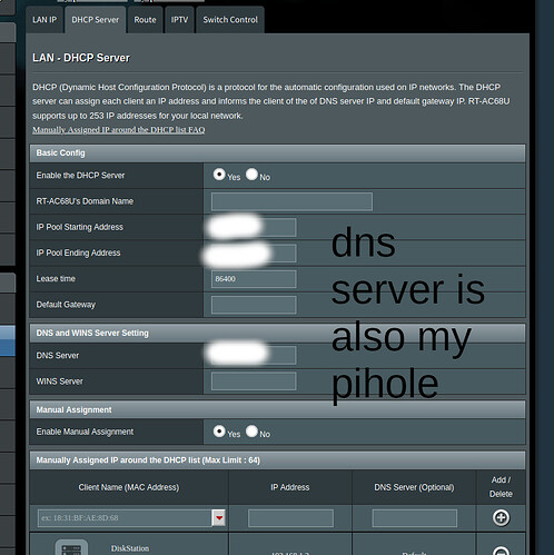

ive uploaded these images hopeflly to give you a better look pretty much all these settings are default on the router other then adding my pihole IP to the LAN dns server entry and on WAN entry on my router other then those two i havent made any changes at all within pihole or my router than what comes as default

Since your screenshots show you've set your Pi-hole as upstream DNS server for your router (via WAN Internet Connection settings), you could have closed such an option 2. loop if you'd configured your Pi-hole to use your router as upstream DNS server (or by using Conditional Forwarding, but your screenshots show you haven't enabled that).
