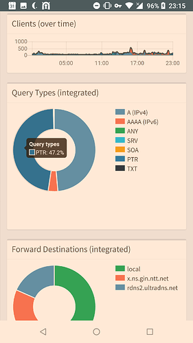

I don't know if it's normal or not, but I can confirm your observation. With one difference, my Pi-hole is also running as DHCP server.
Dashboard reports 47% PTR querys!
Pihole is my DHCP server.
