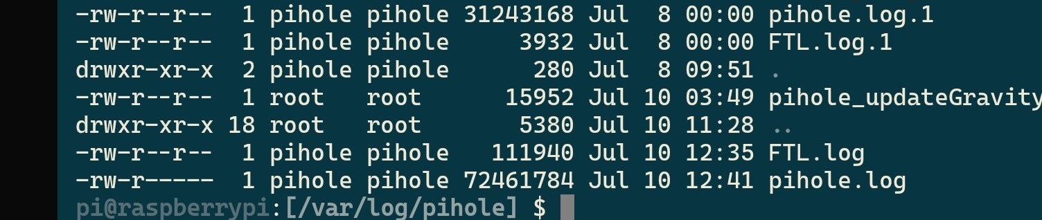

Hi, seeems after move to new location /var/log/pihole/pihole.log logrotation is not working anymore, pihole.log is growing and will fill up my fs.

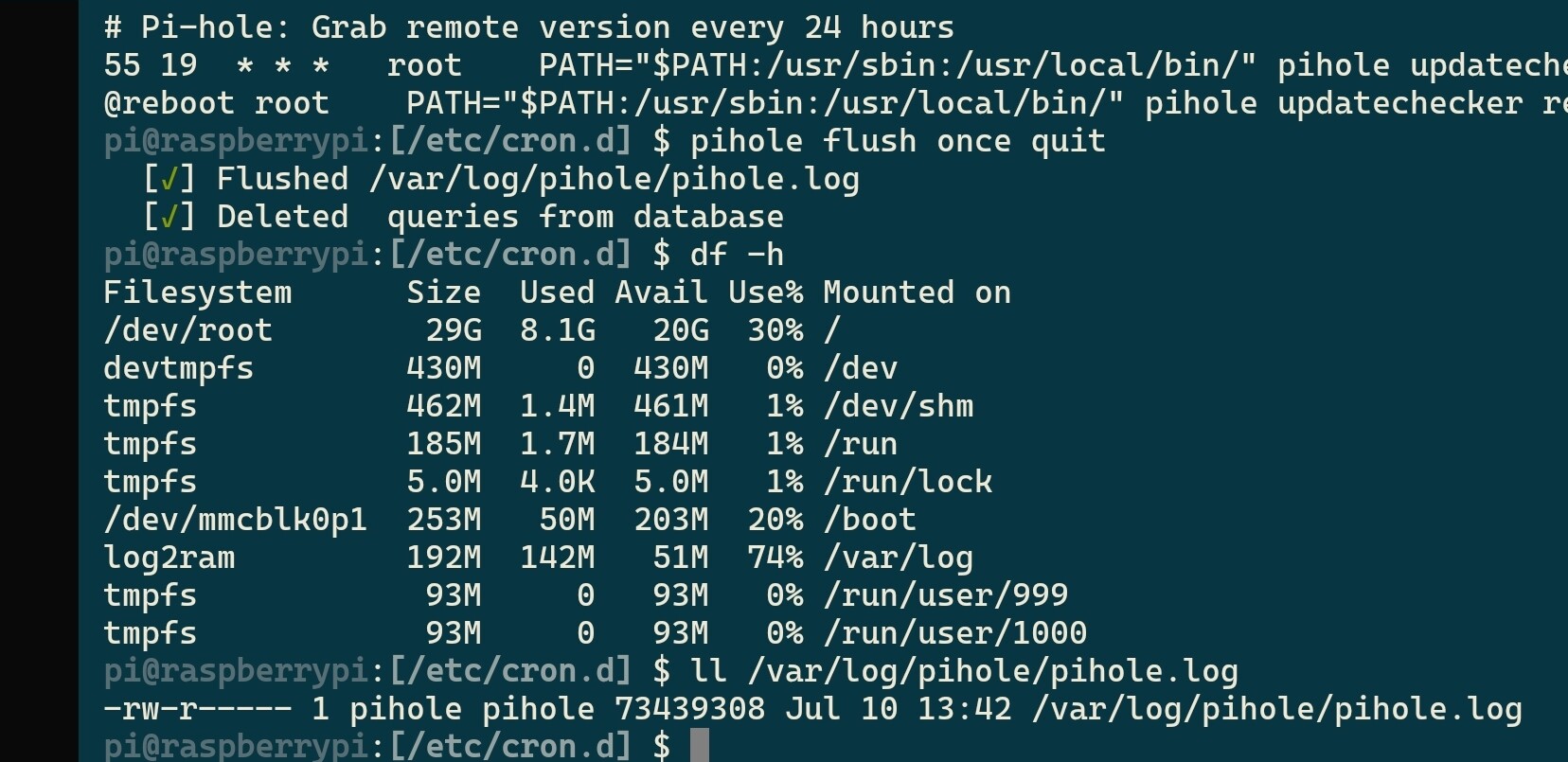

you can manually flush the log, using pihole -f, this will execute /opt/pihole/piholeLogFlush.sh (same as the cron job does).

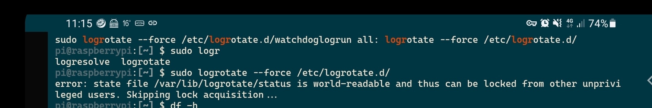

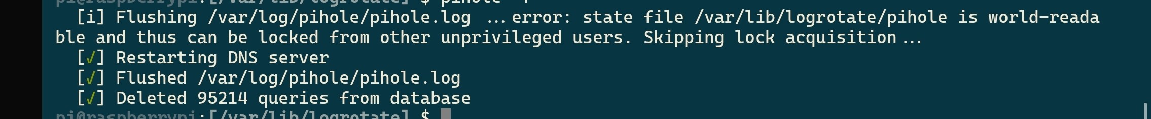

Hm, thx for the info, got
So there is no classic rogrotate as for sysllg etc.?

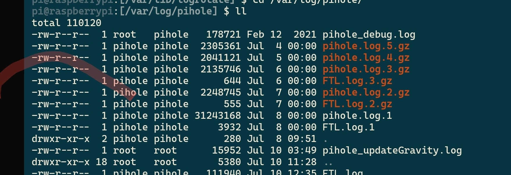

Also it is NOT working
See lag last days
no

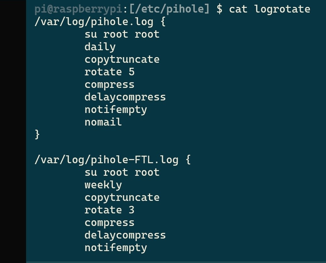

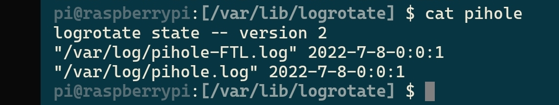

what are the permissions on /var/lib/logrotate/pihole?
Path NOT matching
640 root root for /var/lib/lorotate/pihole

check content of /etc/.pihole/advanced/Templates/logrotate, should match the content of the repository.
edit
if there is a mismatch, there are probably other problems.

At least for me, on my system, I had found that /etc/pihole/logrotate did not match /etc/.pihole/advanced/Templates/logrotate. Once I replaced with the new version, containing the correct paths, it seems to be working.
Not flushing
Indeed, it seems your /etc/pihole/logrotate hasn't been adjusted for the changed log file locations during update.
Since users may choose to customise their log file locations, the update script makes an effort to detect and keep any user applied changes. It seems this didn't work as expected here, and the file was kept as it was.
We are already aware of this and keep track of it in Fix broken logrotate config by updating old paths in existing file if they exist by PromoFaux · Pull Request #4810 · pi-hole/pi-hole · GitHub.

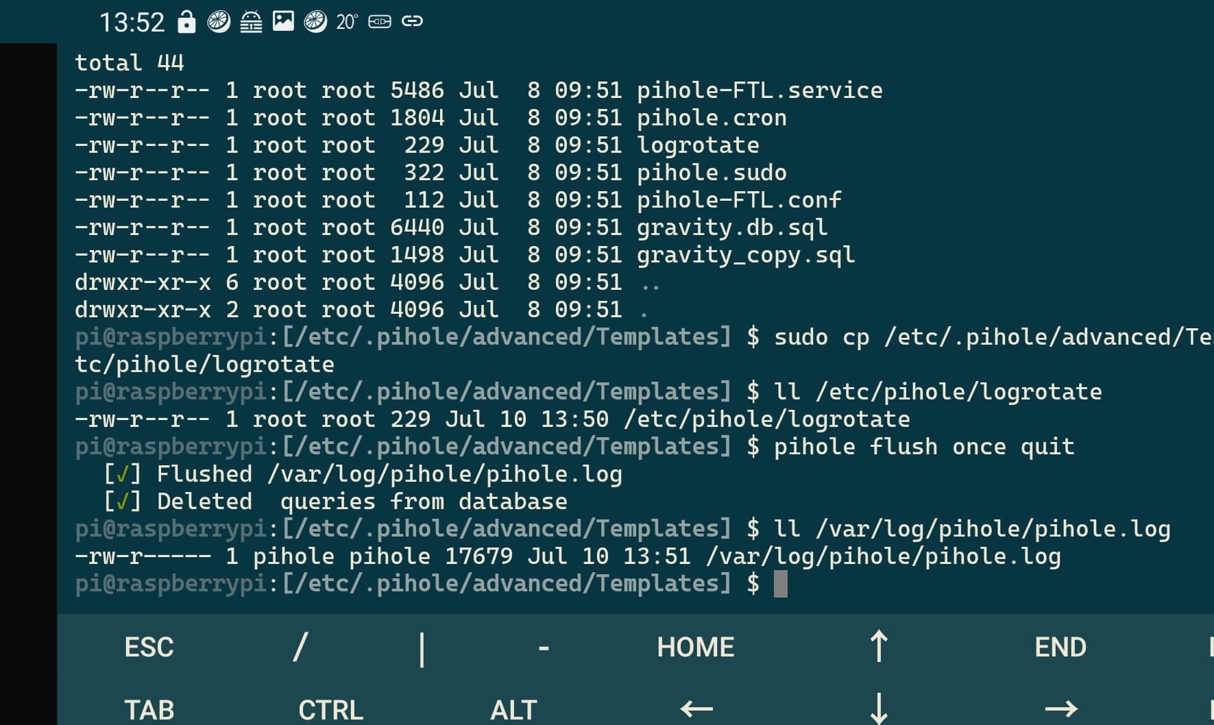

If you didn't touch log file locations yourself, it should be enough to simply copy the template to Pi-hole's configuration, e.g. by
sudo cp /etc/.pihole/advanced/Templates/logrotate /etc/pihole/logrotate
Did the trick
