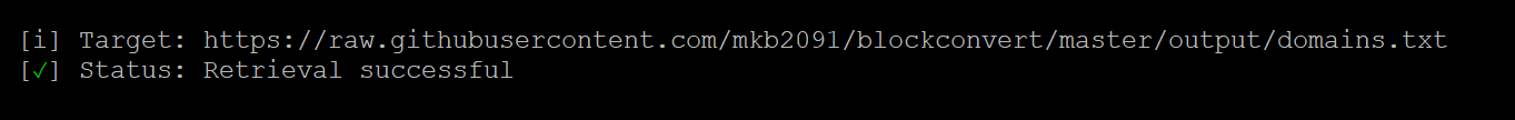

I am currently upgrading pihole to newest version and somehow list retrieving/extraction is killing my pi:
hanging in that single list since now more that 30mins, no end in sight ... should I kill the process or let it run?

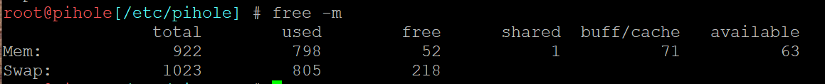

Looking at "top" while the 58meg file was processing, all the pi's ram and swap was 100% used.

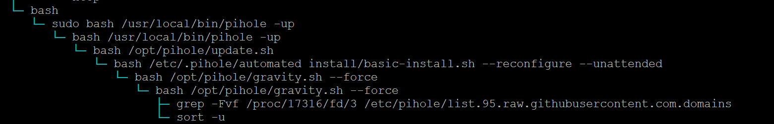

My guess is that the grep -Fvf xxxx process is the cause. It seems to be inefficient when it processes large files, although it will process the same data as smaller files without this issue.

In htop I see memory usage and swap-file usage 100%, system becomes unresponsive.
A grep command by Pihole seems the cause...

Processing has become very, very, very memory hungry (100% RAM, 100% swap-file) and hence very, very slow due to continuous disk r/w operations (swap-file).

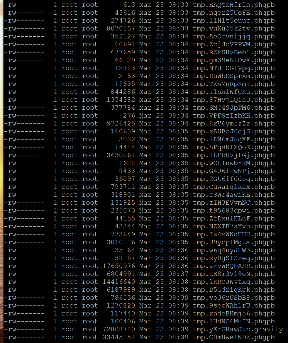

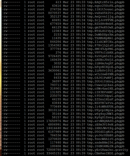

The tmp.*.phgpb files are created by curl when downloading lists. You have a very large number of them, how many lists do you use exactly?
