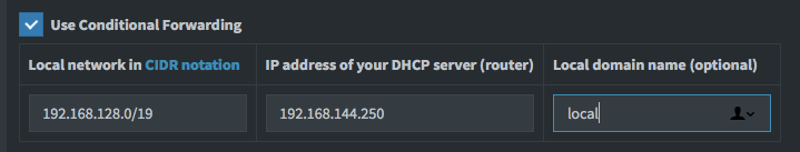

conditional forwarding:
we have two networks configured in the router 192.168.143.0 and 192.168.144.0

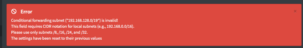

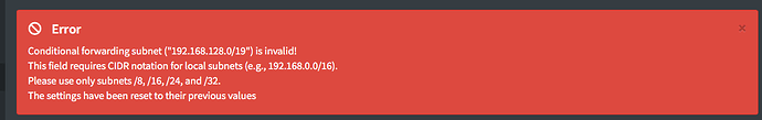

the smallest combined net is 192.168.128.0/19 but the pi-hole gives an error?
Dnsmasq (embedded in pihole-FTL) only accepts octets for the subnet, so you will need to find a combination that works with /8, /16, etc.

we use two networks on our router to divide the clients in two groups. we do this since 20 years with no problem until now. those networks are 192.168.143.0 (255.255.255.0) and 192.168.144.0 (255.255.255.0).
this online calc gave 192.168.128.0/19:
https://www.heise.de/netze/tools/netzwerkrechner/Bildschirmfoto 2020-10-15 um 09.51.42
