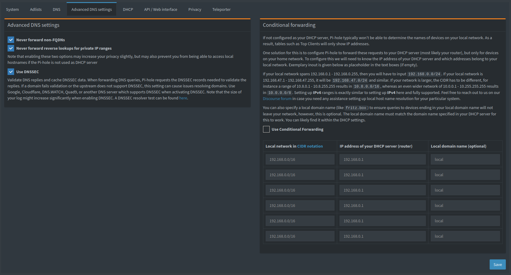

Just use the two /24 networks. You can't do it with the web interface, you'll need to create a custom config file.
You've chosen two subnets that do not naturally group. You've split the networks across a binary domain.
If you had chosen 192.168.142.0/24 && 192.168.143.0/24 then you could have a single /23. But even that would not help here as dnsmasq requires a /8,/16,/24 natural mask for historical reasons. Use those two /24 networks, each pointing to the same upstream authoritative resolver and the same domain name.
we cannot change our networkaddresses just because pi-hole webinterface can't deal with them.
  1. what were two sample networks in the 192.168.x.x range that combine the way pi-hole webinterface can deal with?
  2. where and how to set things up with our actual networks in the 'custom config file' is there a howto? and will doing it via custom config file then break the whole web-interface?
moreover found this - seems that i'm not the only idiot who needs something like this:
pihole-FTL - Pi-hole's embedded tailored dnsmasq - can be configured in any way dnsmasq would allow, unless a configuration option would conflict with Pi-hole's own configuration.
(If done correctly, it wouldn't in your case).
You'd have to create a new file under /etc/dnsmasq.d/, e.g. 42-conditional-fwd.conf.
You need two entries rev-server (for reverse IP lookups) and server (for hostname lookups matching your local domain) in there, and you could use the respective lines from Pi-hole's existing configuration (resulting from your UI CF setting) as a template.
If you are uncomfortable and/or unfamiliar with applying custom configurations for dnsmasq, you could also disable CF and set your router as Pi-hole's only upstream DNS and an unchecked Never forward reverse lookups for private IP ranges and Never forward non-FQDNs under Advanced DNS settings.
EDIT:
Of course, this and Conditional Forwarding would only work if you would indeed have found a way to address your initial issue, i.e. your router using Pi-hole as upstream DNS.
If the latter would still be the case, either approach will create a DNS loop, immensly slowing your DNS resolution or killing it completely.

ok - i had a look at the thing on our pi. in /etc/dnsmasq.d/ i currently have 01-pihole.config that will be the config-file automatically created by the installer or webinterface? and there are also the current entries for rev-server and server. is '42-conditional-fwd.conf' a magic name for a manual config-file that is automatically loaded at startup and overrides the settings in '01-pihole.config'?
well, that doesn't seem to be difficult with your good description of what and where and what the parameters are called.
i'm always a bit worried that things like this will break with the next update and you have to fiddle around with it again so i found a workaround with the web-gui which works quite well for our small net(s).
under 'Use Conditional Forwarding' i first typed in one network with only a few workstations all with the fixed ip via bootp from the router. after 1 hour i typed in the other network with the more often changing clients. somehow it seems to remember this in some table/cache because it now shows all clients in both networks by name.
that's enough for us for now - and apparently the change in the webinterface for entering multiple networks is already in progress on github.

ok. so in /etc/dnsmasq.d i have the config-file (01-pihole.conf) that is auto-generated by the webinterface an says:
rev-server=192.168.144.0/24,192.168.144.254
server=/intern/192.168.144.254
if i want to add a second internal network i have to create a second config-file eg xyz.conf with the second network (both use the same dhcp server)
rev-server=192.168.143.0/24,192.168.144.254
right?
If the DNS server at 192.168.144.254 will respond to PTR queries for the 192.168.143.0/24 range then that is the correct action.
