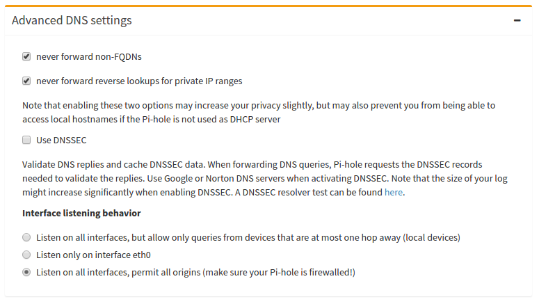

What option have you selected for the listening behavior on the Settings page?
If your Pi is not facing the Internet directly (i.e. behind a firewall / NAT in a router), you can safely chose the last option which leads to that dnsmasq is listening everywhere.

Advanced DNS Settings
Listen on all interfaces, permit all origins .... or "Listen only on interface eth0"
Work great.
Was set to "Listen on all interfaces, but allow only queries from devices that are at most one hop away (local devices)" this make the "trouble"
so my Problem is gone. :slight_smile: THX
