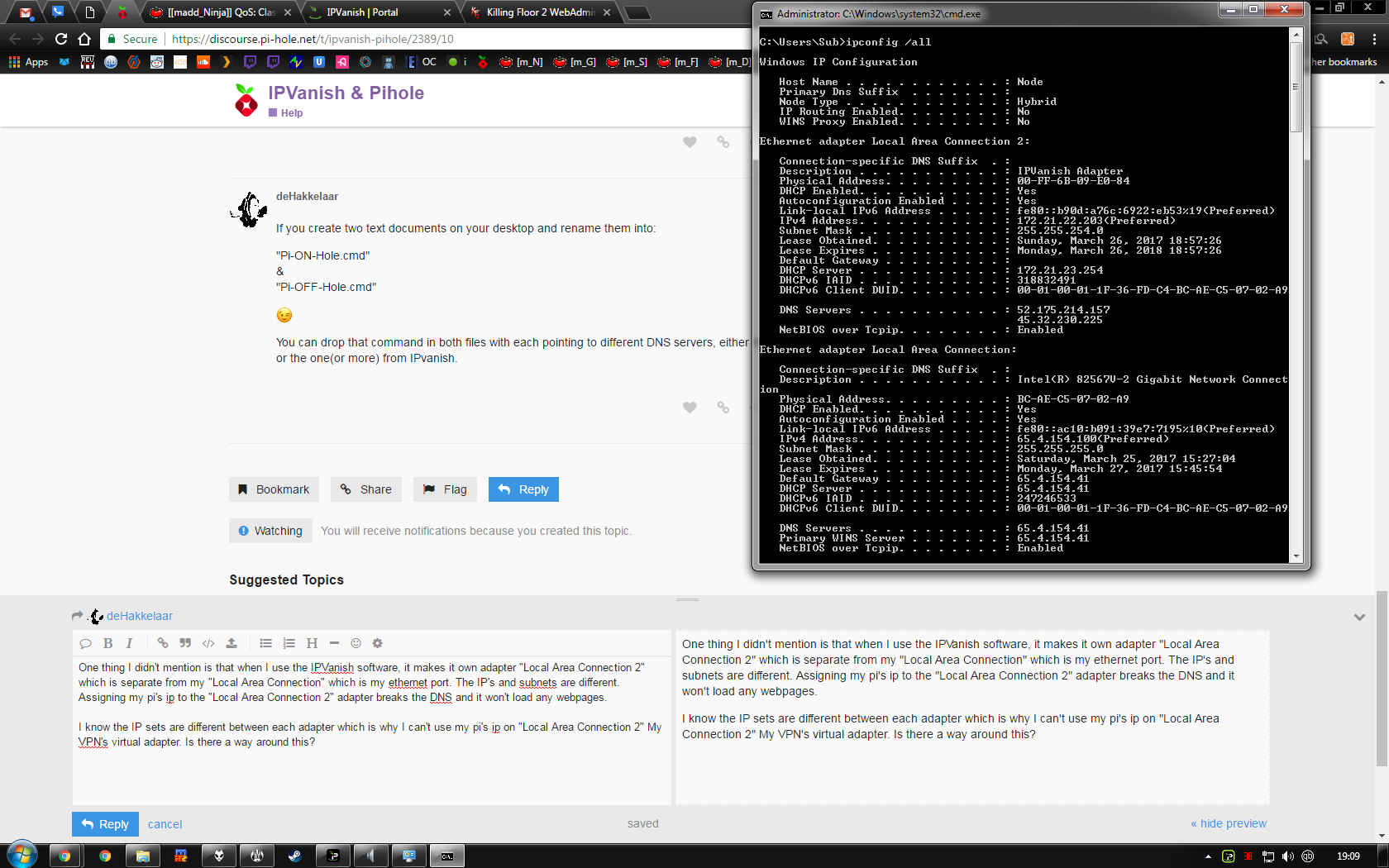

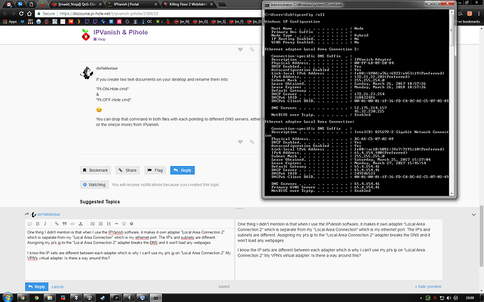

One thing I didn't mention is that when I use the IPVanish software, it makes it own adapter "Local Area Connection 2" which is separate from my "Local Area Connection" which is my ethernet port. The IP's and subnets are different. Assigning my pi's ip to the "Local Area Connection 2" adapter breaks the DNS and it won't load any webpages.
I know the IP sets are different between each adapter which is why I can't use my pi's ip on "Local Area Connection 2" My VPN's virtual adapter. Is there a way around this?
This screenshot is with IPVanish running. At the moment I'm using OpenNIC DNS which is the same DNS assigned into my pi.
